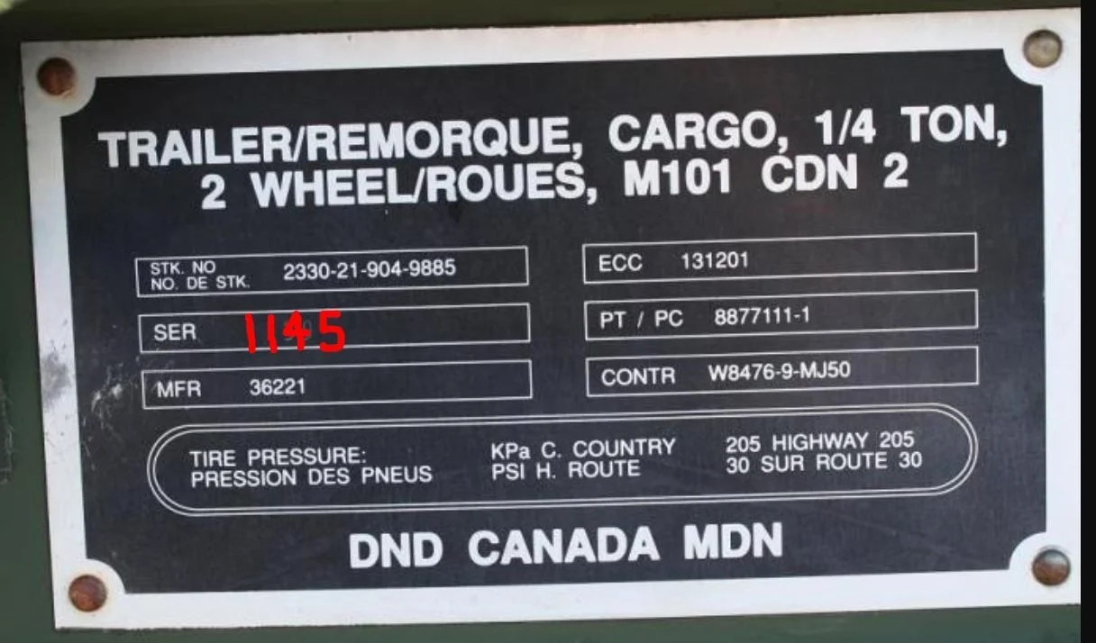

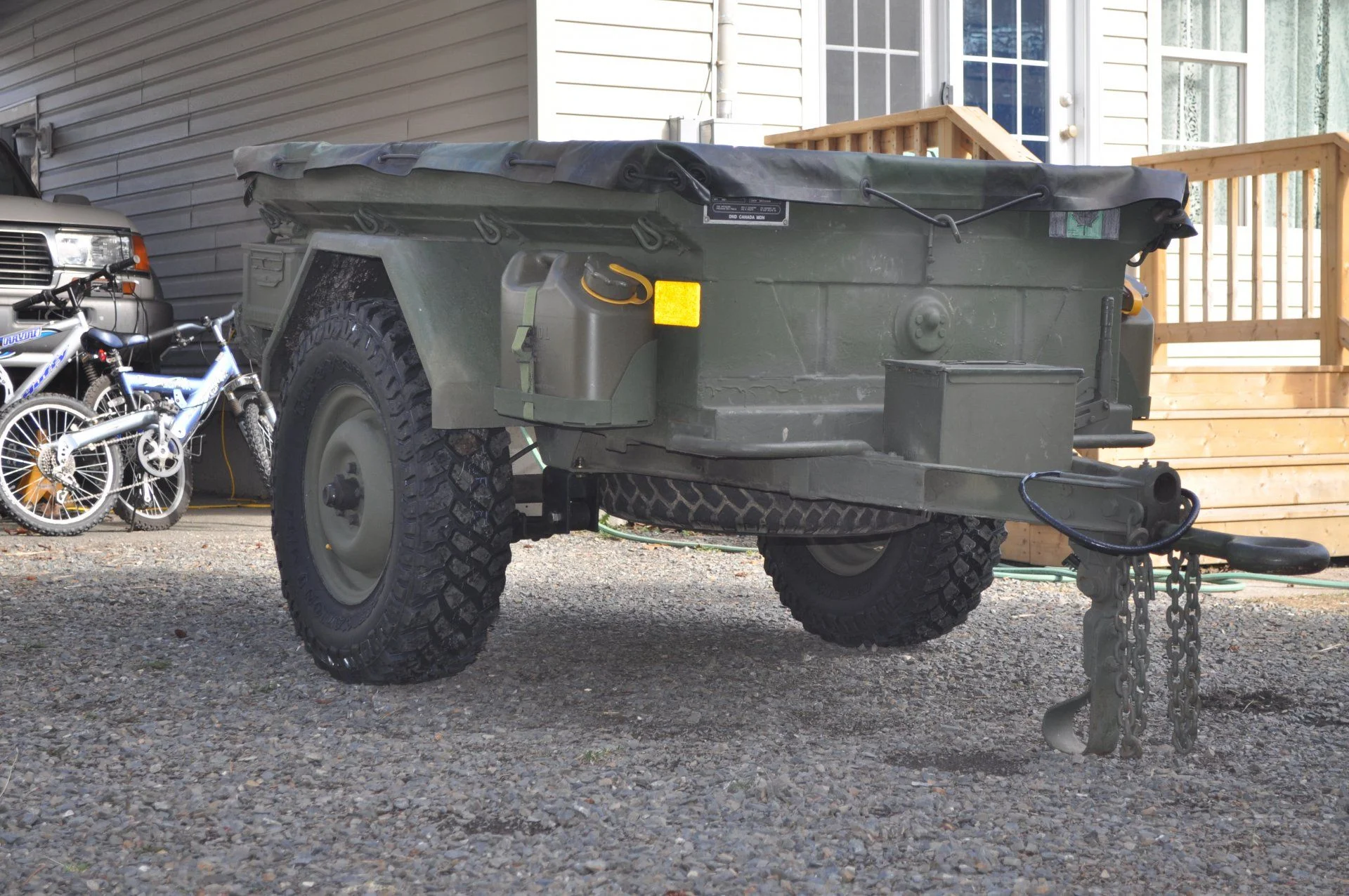

Chris W 09-05-20 18:17
Hi,
I was hoping someone would be generous enough to look up my M101CDN2 Trail CFR information and post it as a pdf.
It is serial number 1145 per these images:
Thanks, Chris
https://forum.ih8mud.com/attachments...e-jpg.2300367/
https://forum.ih8mud.com/attachments...1-jpg.2293676/
Ed Storey 09-05-20 19:08
M101cdn2
Your M101CDN2 Serial No. 1145 was CFR 16338 which was manufactured in 1994 and disposed of out of CFB Gagetown in October 2002. The last recorded user unit was The Prince Edward Island Regiment (RCAC).
