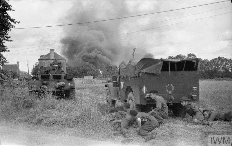

A photo showing a RCCS "Alternate rear link" Scoutcar attached to XII Manitoba Dragoons.
Jack Geratic 24-11-19 18:58
Hello Marco, thank you for posting this photo - many interesting details!
- camouflage style is the early foliage pattern
- AoS number 44 is dark (black?) with white outline - any special meaning to this, or just an attempt at low visibility?
- tactical marking AC2, appears to be close to official size of 8"x6" but have eliminated the 5/8" yellow border due to surface size restrictions?
- bridge class disc looks to be 7" diameter
- unknown serials on center of front bumper
- rear bumper attached, or is that some other detail in the photo background?'
regards,
Jack
Ed Storey 24-11-19 19:16
M3A1 Markings
There is no rear bumper, the AoS 44 should be red and the markings on the front bumper are a CMD number.
