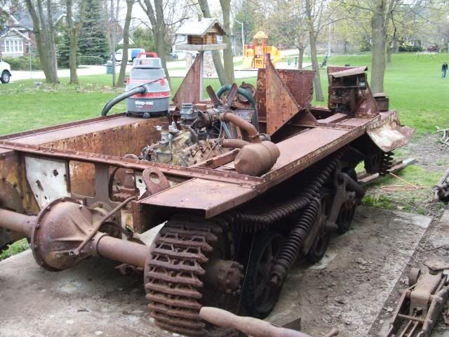

Originally Posted by Ledsel (Post 109584)
You have a start. That muffler doesn't belong but the air filter is proper. Just give the carrier a good clean out when you get it and (DO NOT) :nono: throw any thing out until you are finished with the restoration. Good luck. :thup2:
P.S. What you should do when you get it is tow it around a field or somewhere for a bit, just to loosen up the track somewhat. It makes it a hell of a lot easier to work on and to replace them when they are a bit pliable. This is an Ontario carrier so I have a lot of experience when it comes to anything rusty.
Ledsel..
That canister with the three outlets that can be seen in the photo should have a fourth outlet..It is a heat exchanger for the arctic kit on a CMP .It was installed in the exhaust system just below the floor and hot air was piped up by the fan and blower to the windshield for defrost..a rare item ...
While not a 100% positive it looks familiar..
:drunk: :support:remember
Ledsel 13-02-09 23:24
heater
Originally Posted by Alex Blair (Post 109609)
Ledsel..
Hey, that's good to know, That's what I mean when I say don't throw anything out. Even if you don't need it someone else mite.

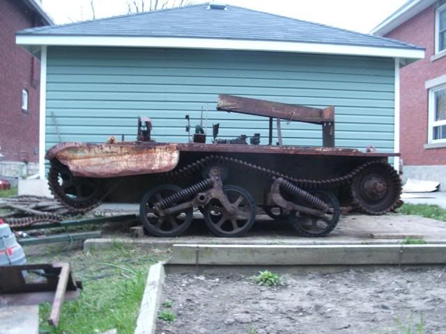

well 12 days to go WOO HOO !!!! Rob has rebuilt the loose bits and will be putting the engine and cover back on the carrier, he will take some pics of it being loaded up so when i get them i will post them up. he tried for hours to free up the seized brake with a negative result so the tracks have had to come off, at least it will be easier to push around..........Iam on cloud nine :D just got to hope pirates dont knab the ship ! been thinking of colour schemes for ages now i want to keep it as per my grandads regiment in Persia / Italy but i just love the caunter pattern........ Kevin what scheme's you going for on your beasts ?
Rich
RichardT10829 07-05-09 18:15
well Rob sent a few pics for me, more to come..... i keep spotting bits which i thought i would need so its always nice to see extra goodies.
http://img.photobucket.com/albums/v4...carrier073.jpg http://img.photobucket.com/albums/v4...carrier074.jpg
http://img.photobucket.com/albums/v4...carrier075.jpg http://img.photobucket.com/albums/v4...carrier076.jpg
http://img.photobucket.com/albums/v4...carrier077.jpg http://img.photobucket.com/albums/v4...carrier078.jpg
still a load of bits to go back on, Rob could not get the break unstuck so the section of track has been removed as you can see. its nicer to see and know the tonne of silt has been blasted out of the tub so you can get a clearer view of the inner workings so to speak. keep saying to myself "GOD WHAT HAVE I TAKEN ON HERE" but she is not too bad really certainly nothing in comparison to the pair that Martyn is building from scratch.

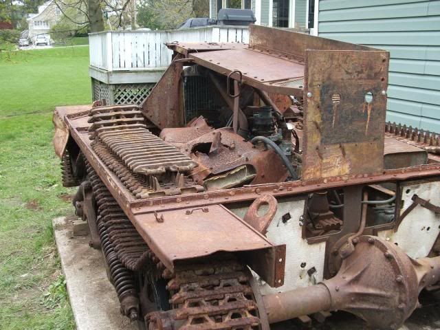

ok last couple of snaps before she gets loaded up tomorrow (will get some shots of that process too) cant wait !!!
http://img.photobucket.com/albums/v4...carrier109.jpg http://img.photobucket.com/albums/v4...carrier112.jpg

I would say by looking at the pictures, that the tracks are not to badly seized. they managed to remove some pins and tie the track up. More likely that the brakes have seized on, is why she didn't role? When do you expect delivery?

on the last picures (left hand one rear shot) can anyone tell me what the little bracket type peices are on the rear fender ?
Rich
kevin powles 11-05-09 12:48
Hi Rich, He's done a great job packaging it up, well done to him, neat way to carry the upper lengths of track.
those brackets, one is for cliping in place the starting crane handle, the other is the little thinging for holding the rear tarpaulin in place, they are called footman loops.

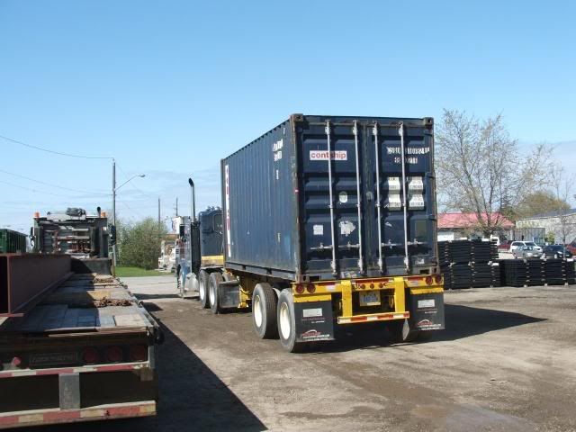

RichardT10829 12-05-09 10:11
sure no problem Mal, i will let you know when she arrives.
Rob sent the final pics last night so it was nice to read my emails when i got in from work.
http://img.photobucket.com/albums/v4...carrier113.jpg http://img.photobucket.com/albums/v4...carrier114.jpg
http://img.photobucket.com/albums/v4...carrier115.jpg http://img.photobucket.com/albums/v4...carrier120.jpg
http://img.photobucket.com/albums/v4...carrier123.jpg
so only pics to add will be the delivery, then iam not sure wheather to start a restoration thread or add to this one ;)
