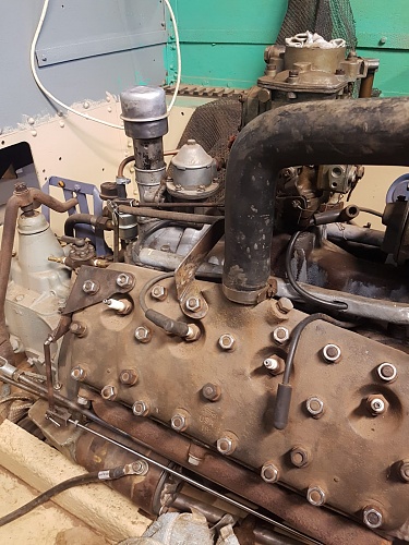

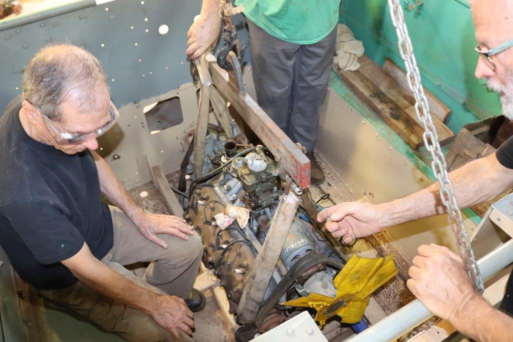

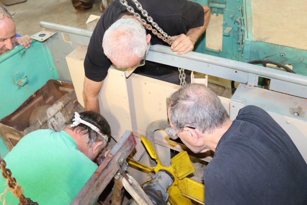

Israel Berko 14-09-19 10:27
BC Restoration project
5 Attachment(s)
Installing the Engine in BC - Yesterday
https://youtu.be/YdWEUAm-soQ
Attachment 109082
Attachment 109083
Attachment 109084
Attachment 109085
Attachment 109086

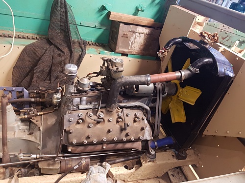

Israel Berko 03-01-20 18:33
BC Restoration project - first Friday of 2020
5 Attachment(s)
first Friday of 2020 install radiator attached pictures :thup2:
Attachment 111213
Attachment 111214
Attachment 111215
Attachment 111216
Attachment 111217

rob love 20-02-20 01:59
1 Attachment(s)
I notice you are using straight hoses on the lower rad to water pumps. Although you are using silicone hose, which will bend reasonably easy, you might want to consider using the preformed rubber hoses from a 52 Ford. It reduces the stress on the lower rad outlets.

super dave 20-02-20 07:12
1 Attachment(s)
Originally Posted by Israel Berko (Post 266883)
Hi
I am looking for the radiator top mounting / top latch of the radiator I would love to get a scheme that describes the installation.
Thanks, Israel
I believe this picture will help you out as there is a bracket that bolts to the tab off the rad and then bolts to the upper engine armor.
