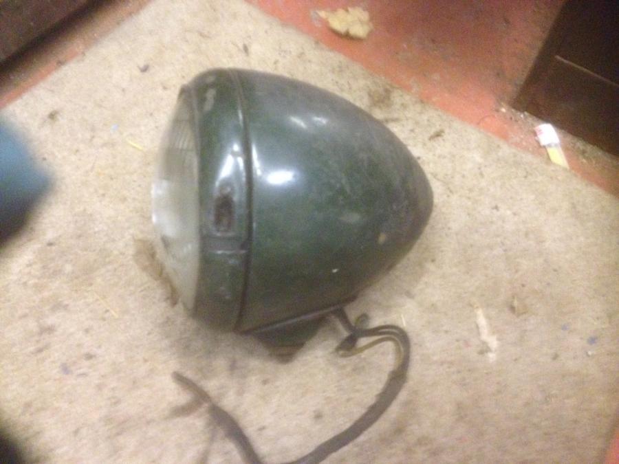

John A. Rippingham 15-12-14 23:38
smiliar headlamp
2 Attachment(s)
Similar headlamp but no makers stamp, 9" diameter.
Attachment 69884 Attachment 69885

Maurice Donckers 15-12-14 23:49
6 cilinder distributer cap is from Chevrolet ,GMC, and some of the bigger trucks
first headlight if guide , then also from GMC .
the second headlight looks to me from a post war Dodge.

John A. Rippingham 16-12-14 00:19
Thanks for your help maurice, the gmc headlamp had a lucas lense in it, thats what threw me...

rob love 16-12-14 07:01
Attachment 69884
Attachment 69885
Look like Dodge M37.

motto (RIP) 17-12-14 23:39
The headlight in post #5 is for Dodge M37 as Rob says.
