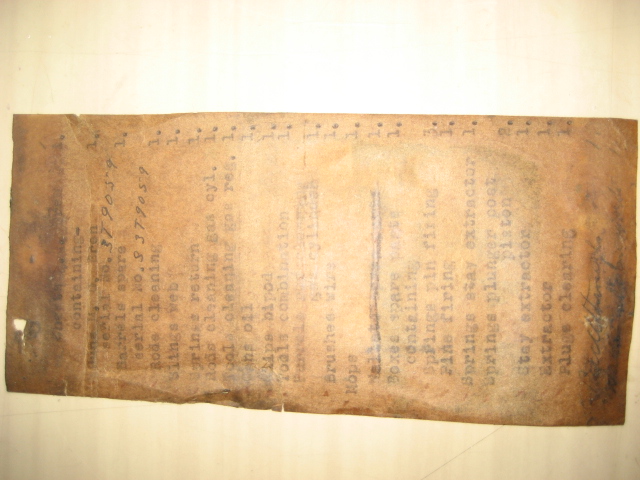

Contents
I have an original tag pasted on the inside lid of my bren chest which says;
Chest . . . Bren 1.
containing-
Guns M.G. Bren 1.
Serial No. _______
Barrels spare 1.
Serial No._______
Rods cleaning 1.
Slings web 1.
Springs return 1.
Rods cleaning gas cyl. 1.
Tools cleaning gas reg. 1.
Cans oil 1.
Clips bipod 1.
Tools combination 1.
Barrels rod cleaning
gas cylinder 1.
Brushes wire 1.
Mops 1.
Wallets spare parts 1.
Boxes spare parts 1.
containing
Springs pin firing 3.
Pins firing 1.
Springs stay extractor 1.
Springs plunger post
piston 2.
Stay extractor 1.
Extractor 1.
Plugs clearing 1.
Pullthroughs 1. (handwritten in)
This tag was typewriter made and is very oily but still readable.

Label
I am slow in responding with the picture but trying to learn to post pictures by myself has not gone well.I have tried this many times and failed.The last time I tried,I shut the computer off with my fist! Now I have had a few weeks to cool off and will try this again.
http://www.alfrules.com/derk/bren label 070.jpg

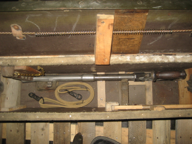

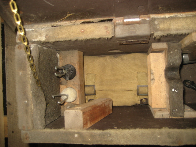

Contents

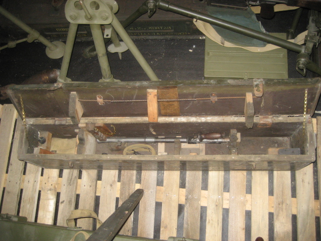

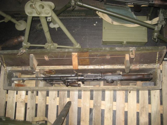

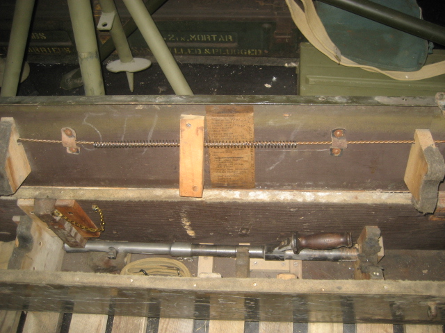

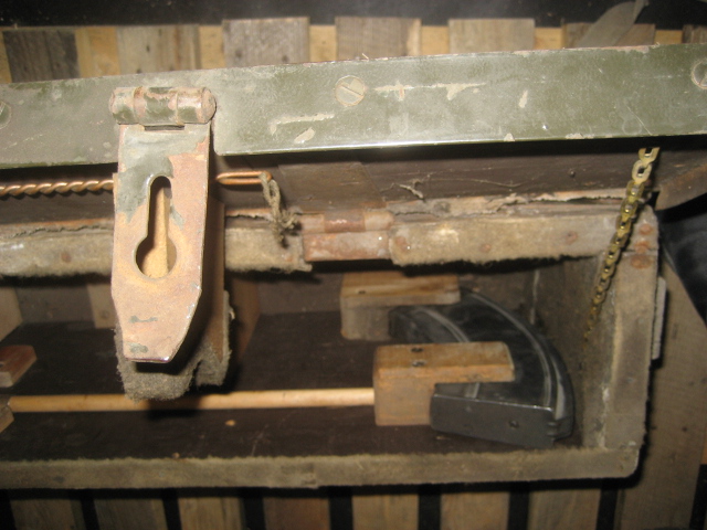

Here is a shot of my transit case with the items placed in there cubby holes.The only spot I don't know what goes there is in the middle section,there is a square area with 2 strips of wood screwed to the bottom and a strip of wood screwed to the front section of the box that hinges sideways to hold the item in place securely.The square area measures 3 1/4'' x 3 1/4'' x 3 1/4'' high.Any ideas?
http://www.alfrules.com/derk/IMG_7261.jpg 004.jpg
http://www.alfrules.com/derk/IMG_7261.jpg 005.jpg
http://www.alfrules.com/derk/IMG_7261.jpg 006.jpg
http://www.alfrules.com/derk/IMG_7261.jpg 007.jpg
http://www.alfrules.com/derk/IMG_7261.jpg 008.jpg
http://www.alfrules.com/derk/IMG_7261.jpg 009.jpg

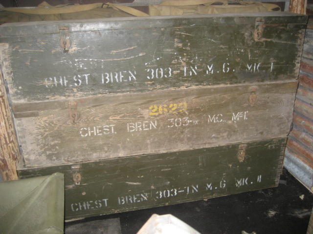

Here are all 3 boxes,the bottom box is a MK 2 which is 1'' longer than the MK 1 boxes to compensate for the longer butt stock strap of the MK 2.
http://www.alfrules.com/derk/IMG_7261.jpg 010.jpg

Derk,many thanks for the picture of the contents.
The middle compartment held the grease tin.
All the best Kevin

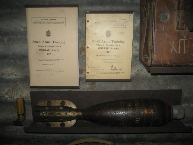

3'' mortar manual
Peter,
If Stewart is not interested in that 3'' mortar manual,I would like to buy it as I do not have that manual for my mortar.I have a copy of a 1939 3'' mortar manual and an original 1943 manual but Don't have the one you have.Please let me know.Thanks,
Derk.

Hi Kevin,
Would you have a picture to post on what oil bottle I need to find so I know what to look for,thanks.Are all my items in the proper places in my chest or have I got anything wrong?
Derk.
derk derin 07-01-10 08:12
grease tin
I mean grease tin,not oil bottle! (damn diesel fumes)

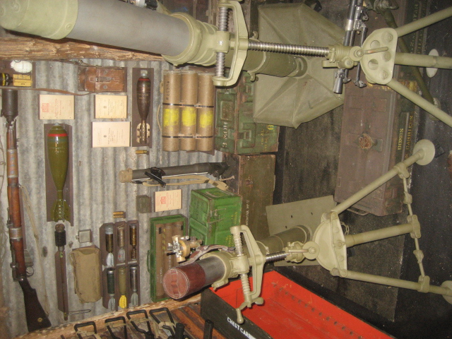

Holy crap Derk.... that is an impressive set up you have there. Any chance of some photos of the whole room? Or rooms, or bunker, or whatever you got going on there. Guess I'll have to make my way back to Manitoba one of these days as apparently that's where all the good stuff is.
