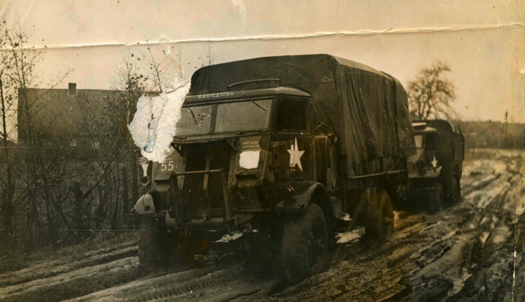

Ilian Filipov 18-02-19 10:31
2 Attachment(s)
Originally Posted by Dusonn (Post 258441)
Apart from the longer wheelbase, the most significant feature that differs WOT6 from WOT8 is the demountable top half of cab, with the two handles just under the windscreen and a cover stripe over the gap.
Hi Dusan,
Till recently I've also thought so because it is so in theory. But the life can ruin any good theory.
I'm sure you're familiar with one of these WOT8 pictures at least, if not with both:
https://i.postimg.cc/cLdTD4TZ/wot8-1.jpg
https://i.postimg.cc/2STGgRXW/wot8-2.jpg
Maybe they are field mods but this can't change the things.
That's why I wrote above the wheelbase is the only sure ID.

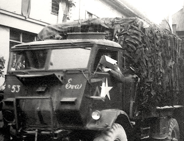

Dusonn 18-02-19 11:44
Hi Ilian,
I am pretty sure these are WOT6s on both of your pictures. The first one is WOT6 "EVA" one of about 25 that came with the Czechoslovak Armoured Brigade Group to liberated Czechoslovakia in May/June 1945. On the internet it is wrongly described as WOT6. We have not found any file that would indicate that the WOT8s which the Czechoslovak army had in Great Britain crossed the channel to France after D-day+. All were swapped for other vehicles.
I am not familiar with the second photo but that would also be WOT6. It is just the angle of perspective that makes you think that is has a shorter wheelbase. But the devided cab with handles indicates it clearly, so do the fender pyramid stripe "steps".
Note that the large tank behind the cabin was mounted to both 8s and 6s.
