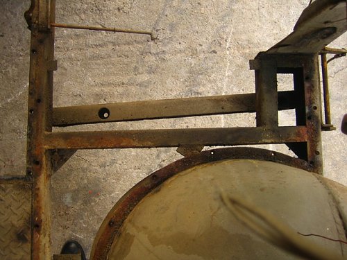

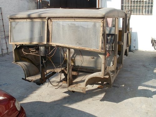

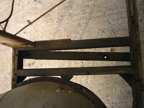

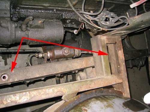

Thanks to you and R. Clark (HERE) we saved a lot of time and pain, and we finally managed to remove the body from the chassis. We remove the front sections and we found the hidden bolts. Everything was there.
The chassis revealed in a tired and rusty shape, but the good thing is that there are no cracks or other lethal damages..
Next phase is to sandblast the chassis and other parts in the comming days, as long as we have the weather on our side. Three weeks without any rain...
The 1st photo is from mr. Waterman's site. 2 to 5 is the HUW.
