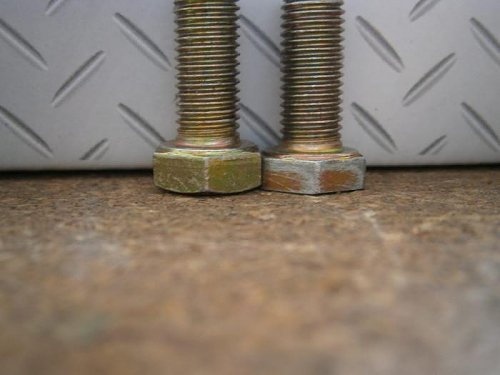

To get the proper fit I had to:
Name:	door bolts.jpg
Shave the hinge bolts to correct thickness.

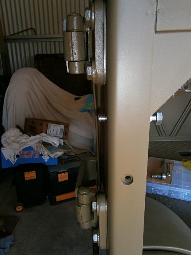

Name:	windscreen frame packing.jpg
Pack the windscreen frame so it didn't stick out the side too much.

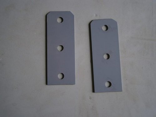

Name:	door shims.jpg
ID:	48320 Click image for larger version
Name:	door shims 2.jpg
Shim the door for better clearance. Two shims top, and one at bottom. Yes, I know they look a bit rough in places, but you don't see those parts. Heres a little wrinkle, when I made the second & third ones, I shaped the cut-outs sloping slightly downwards. That way they sit in place nicely, without moving around.

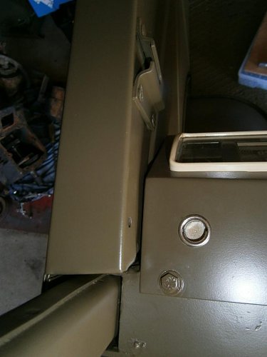

That was the only way I could get a decent clearance between the door and dash panel. At one point it touched strongly. I was not always able to actually see the touching point, so I would slip a piece of paper down there, and when it moved freely I knew it was clear. Now it's well clear, thanks to the second shim in top hinge and moving the dash itself as far away as I could.
