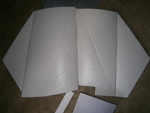

The insulation was easy enough to cut with a box knife. Also making sure to cut part way through where the cover metal has the bends. Negative folds required removal of a small 'v' of the foam from back side, so that insulation would bend correctly without bunching up.
Name:	engine insulation 2.jpg
It sit quite well, but make sure it's in the right place before touching it to the surface or there will be a huge effort getting it unstuck. I tried that on purpose on the workshop door before I started the 'real' installation. There would still be some there now if I hadn't used turpentine to remove it!
