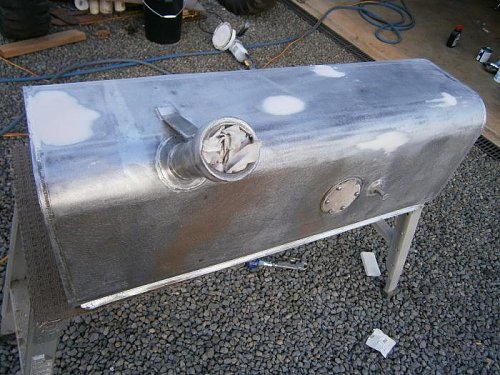

Default Fuel tank repairs
Name:	Driver side tank repaired 1.jpg
ID:	51766 Click image for larger version
Name:	Driver side tank repaired 2.jpg
ID:	51767 Click image for larger version
Name:	Driver side tank repaired 3.jpg
Work continued on the driver side fuel tank last Sunday. As expected, it was not completed before lights out. This is partly due to the unexpected 30 minutes worth of rain at 1500hrs that halted work. When safe to continue, it was already cooling down significantly and my final act was to apply a coat of etch, before shutting down for the week.
Name:	Driver side tank repaired 4.jpg
I will be taking the etch coat off tomorrow. It 'blushed' from the low temp and moisture formed on the surface. That means it will also have allowed moisture through to the metal.

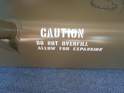

Name:	Tank stencils.jpg
Passenger side tank now finished, including cap with the new seal I made. I bought the tank stencils when I got the bridge loading plate a while ago. They may not be CMP genuine, but I like em!
