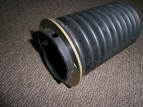

Name:	Booster boot 5.jpg
Slip the securing ring onto the rubber boot. If you have chosen wisely it will be a nice snug fit, even at the end where it is not flared. If it doesn't look like this, either adjust the part i'm about to say next, or.............buy another one!

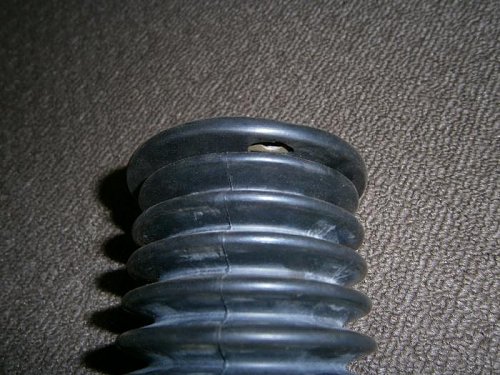

Name:	Booster boot 6.jpg
Move the metal ring onto the boot, one place along.

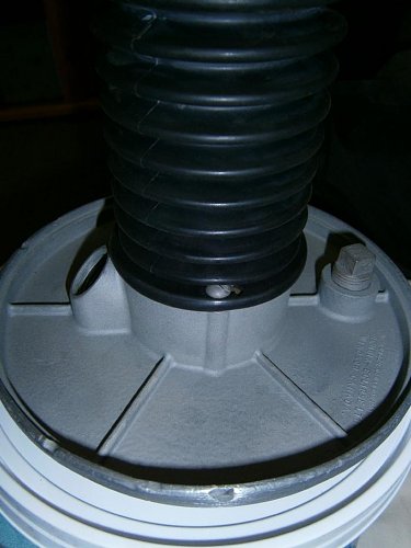

Name:	Booster boot 8.jpg
This shows how it will look with the screws in place. If you wish to do as I did, and remove rubber from around the screw head, punch these locations in a similar way to the screw holes. I did them while the screws were in place and I folded enough rubber back over to allow access for the punch.
Name:	Booster boot 9.jpg
And this is what it should look like when finished. I intend to paint the metal ring & screws black, so they don't highlight that I stuffed up one of the 'cut-outs', around the screw head you see in this photo.
How's that for a nice little wrinkle? Cheap and very functional. Quite easy really! Pity it can't be permanently attached to the booster front plate just yet. The other end of the boot will have to be formed around the top end before this can lower end can become permanent! That's another story, for another day.
