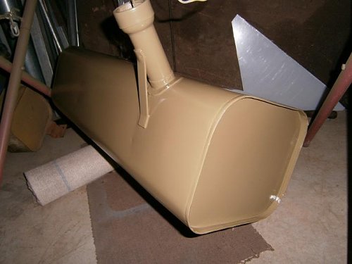

Name:	Driver side tank painted 3.jpg
ID:	51845 Click image for larger version
Name:	Driver side tank painted 2.jpg
The second fuel tank is now painted. I'll put the stencils on some time during the week, as always, weather permitting. I nearly put off todays painting due to high wind speed.

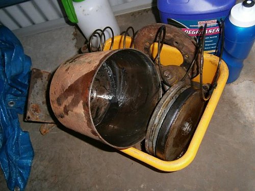

Remember I was intending to send the vac booster shaft & valve assembly for restoration down south? I made a thorough check of that part today and found the valves were in PERFECT condition. No perishing to the rubber seals and no corrosion to the inside of the tube or valve shaft. All it needed was a little cleaning! I did instal a new set of seals on the plunger itself. Had them soaking in oil O/N.

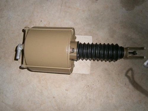

Name:	Vac Booster finished 1.jpg
After I painted the front cover and linkage fork, I reassembled the entire unit and connected it to the workshop vacuum (appropriate!). It works excellently and smoothly. I found when I held the fork end up and actioned the valves as if braking, it could lift its own weight and another 2-3kg besides (added some other parts and tried again). If fact, when trying to forcefully restrain the plunger from moving, I found I could NOT stop the action! That'll do me

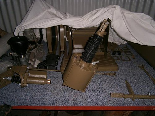

Name:	Finished parts 1.jpg
Booster now added to the 'clean' pile of parts.
