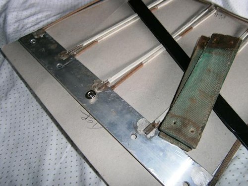

Todays debarcle
Thanks to bad weather, today was a let down. No painting could be done. Rained off & on all bloody day, with not even a patch of clear sky to apply a quick couple of coats and rush the parts inside again.......while laughing maniacally They will wait until better opportunity presents.
Name:	Mud flap frames ready to cover.jpg
Instead, I worked on the front mudflaps, and now have them ready for the upholsterers. The guys had a great & clever way to ensure the canvas layer over the upper plate stays in place and doesn't twist while tightening bolts to mudguard. Simple really, make all the holes a tight fit for an eyelet (think thats what it's called) to be tapped into place once the canvas is finished. In the above photo, you can see one of the eyelets that will be used, along with the two original door check-straps. I'm hoping the upholsterers will be able to find a good substitute for these hard, old ones.

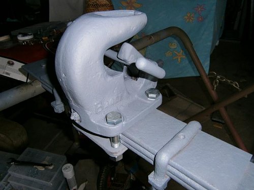

Name:	Pintle test fit 1.jpg
Finally, I got to prepare the pintle parts for paint, and made a trial fit to make sure the bolts would sit correctly. After removing a little metal on the spring set where pintle bolts pass by, everything lines up well.
