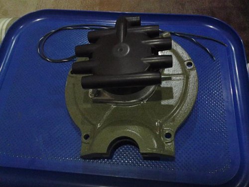

A few weeks ago, I had come across a supplier who had brand new aluminium double pulley water pumps. They are heat treated to 'T-6', whatever that means exactly (I know it means they are stronger), and they have modern double sealed bearings inside. They also have a curved impellor, as opposed to the original straight type, meaning better water circulation and more efficient cooling. These water pumps are a direct replacement for the original ones. Although my block is a bastardised hybrid of 59A & 8BA, these new pumps are a perfect fit. There is an additional water hole coming out of the block, which will sit slightly above earlier style pumps, but it is of no consequence, as the other end of the channel lies under a portion of the head gaskets that does not have a water jacket hole. I will be sealing this channel with a suitable threaded plug or 'mouldable steel' material. This may not be required, because in theory the water cannot exit past the gasket, BUT theory doesn't always equate to practice, does it? Moving on.... The pair of water pumps are now painted and ready for installation. I have chosen NOT to paint the double pulleys. They were polished by me instead. The reason for this will become clear as you continue to read.

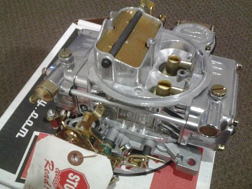

Since my tax return, I have been able to purchase/order some of the major parts I was still needing to assemble the new engine. "New" is by far the best description. I have come to the conclusion that I will be happier with using as many new (or modern) components as I can locate, for reasons of functionality as well longevity. At times, the hot rodder in me has come out as well. Best example of that would be the chucking of the old 97 carburetor, and substituting a 4 barrel Holley 4160 series in it's place!
On a more subtle note. The distributor has been disassembled, cleaned, rebushed, lubed, and treated to an electronic ignition system. It is still a 6v positive earth system, and apart from the two wires exiting the distributor body where the coil was, you can't see any external evidence of the change. I am assured that a better, stronger spark, will be the result of this change. Time will tell if that's correct, but the lack of ANY moving parts of the electronic module itself, and being an entirely sealed unit without breakers, is a very attractive proposition. A new 6v coil from Macsauto, and original looking but modern specs HT plug wires will complete the assembly.
ID:	59936 Click image for larger version
