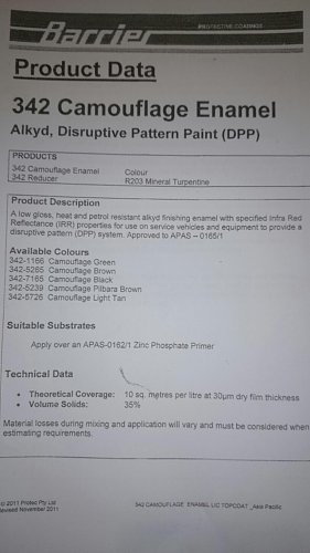

Default Camo Color Codes, Barrier, Protec.
Some time ago, I had a couple of enquiries regarding colors available pre-mixed in the type of paint I am using. That was too long ago for me to remember who those guys were, please excuse my memory.
Name:	Barrier Camoflage Codes.jpg
While at the paint shop on Wednesday, I acquired an up to date list of colors presently available off the shelf. My color is 1166 code. If using this type of paint, I whole heartedly recommend addition of the applicable hardener. My chosen ratio is 15% hardener by volume.
Be aware all colors are available in 4lt ONLY, so far as I am aware. Mind you, 4lt doesn't go that far, so wouldn't be that much of an issue.
