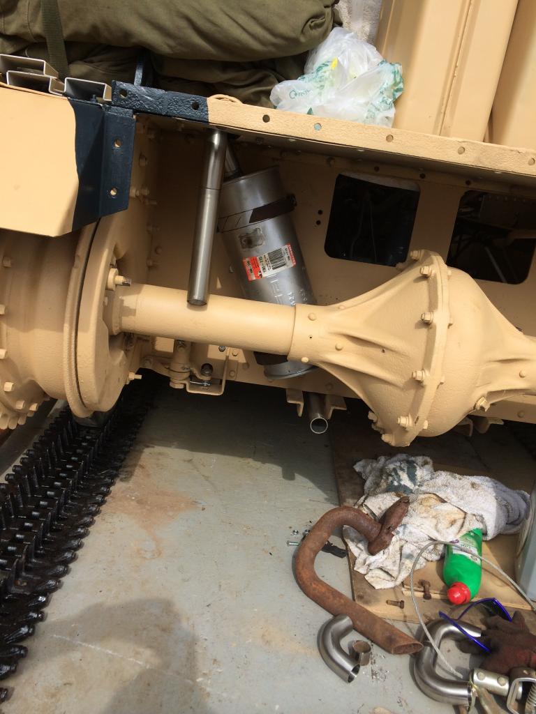

Point to note the bosal one is the only one that fits from the saxo, the rest are oval cans.... They are te exact same size length as a carrier can, and the diameter is the same too.
I am busy making mine, images etc on my thread, I make the top loops and bottoms out of stainless steel.
Richard,
Thanks, seen your work on your thread, looks good! Can you post a picture of sticker info / part number of the Bosal muffler?
Michael sent me a picture of an original Carrier muffler, they are 42-cm or 16.5-in long, whereas the truck one is a tad longer at 18-in. Of course the Carrier uses two mufflers whereas the truck only uses one.
