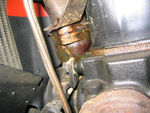

Here are the photos I was talking about, because of the slight angle of the Chevy engine in CMPs often makes it so a leak up front may drip on the floor far back on the engine. There is a lip on the front of the bell housing shield that sticks out and catches anything flowing down the front of the bell housing.
Name:	Coolant Leak front.jpg
ID:	69276Click image for larger version
Name:	Coolant Leak path.jpg
Until I carefully followed the leak path, I thought there were two leaks one front and one rear. In all my years of playing with these engines I have actually only heard of one of these plugs rusting through and that was on a CCKW that started loosing water/coolant ant the rate of gallons to the mile. Friend made it home with the truck by refilling the radiator several times.
If you have confirmed that the leak is positively coming from the rear plug then I'd go with pulling the whole unit.
