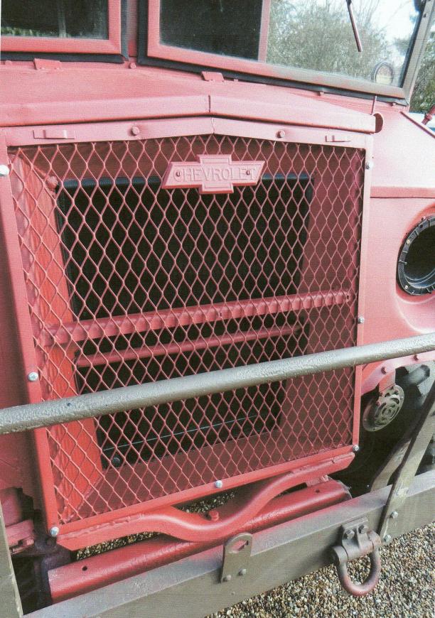

In the last few days I've remade the grille as the replacement I had was a bit ratty. A bit of a grit blast and paint and it's come up well - Pic 1.
