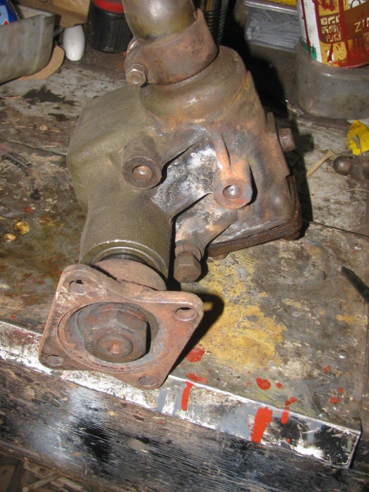

One of the three holding bolts had sheared off many years ago below the steering box mounting face. Plenty of heat did no good. I had to carefully centre punch the broken bolt and then gently drill it out using about 4 drills of increasing size until the thread was just visible and then I taped the remainder out. That took about 4 hours to do.
