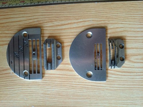

With speed significantly reduced, it's time to improve the ability to handle thick materials. Once again, this can be done easily and cheaply. Installing a heavy duty feed dog (set of teeth) and cover plate is quick and only cost $15 in parts! You can easily see the dramatic difference in size between STD and heavy duty sets. Lots of extra grip gained here!
