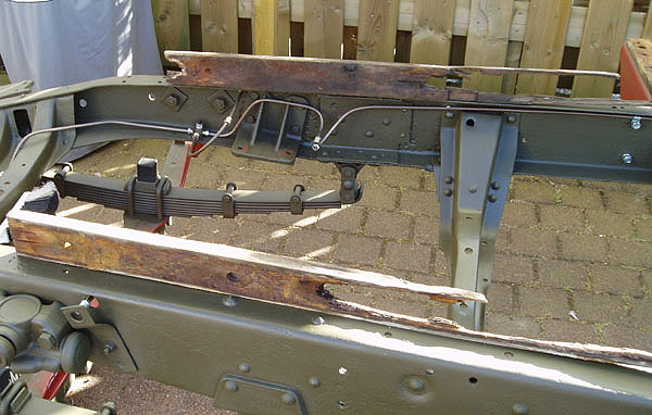

Time for the wooden spacers; Phil Waterman uploaded some excellent pictures and measurements of the woodwork onto his website. I copied the measurements onto some new Oak, but of course I should have known better....the C8 wooden spacers differ from the C60S ones, as the chassis rails are quite different! So, in the end I combined Phil's pictures with the info and measurements that I was able to retrieve from my rotten C8 spacers and made the new ones.
I treated the spacers with a coat of Owatrol (a wood preserver) and made sure it soaked into all grain and holes. This was followed by a coat of black primer mixed with Owatrol, a coat of Khaki green with Owatrol and finally pure Khaki green. Only the last coat was done with the spraygun, the other coats done with a brush.
Soon afterwards I realised the long spacers were in fact too short! My original spacers were so rotten that I hadn't noticed that the straight edge at one end was not the actual end of the wood, but in fact the remains of a cut made to clear the steel cab floor supports. The spacers were about 20cm too short, so I took some more oak and fixed the issue.
The spacers are now waiting till I have the floor done.
