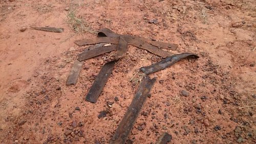

May be some perforation to wheel arches, but am not sure until blasted. The rest of the frame is OK. Lower rear panel is very badly corroded in the angle piece and panel sheeting.

Also the cross bracings are affected, with two needing either repair or replacement.
