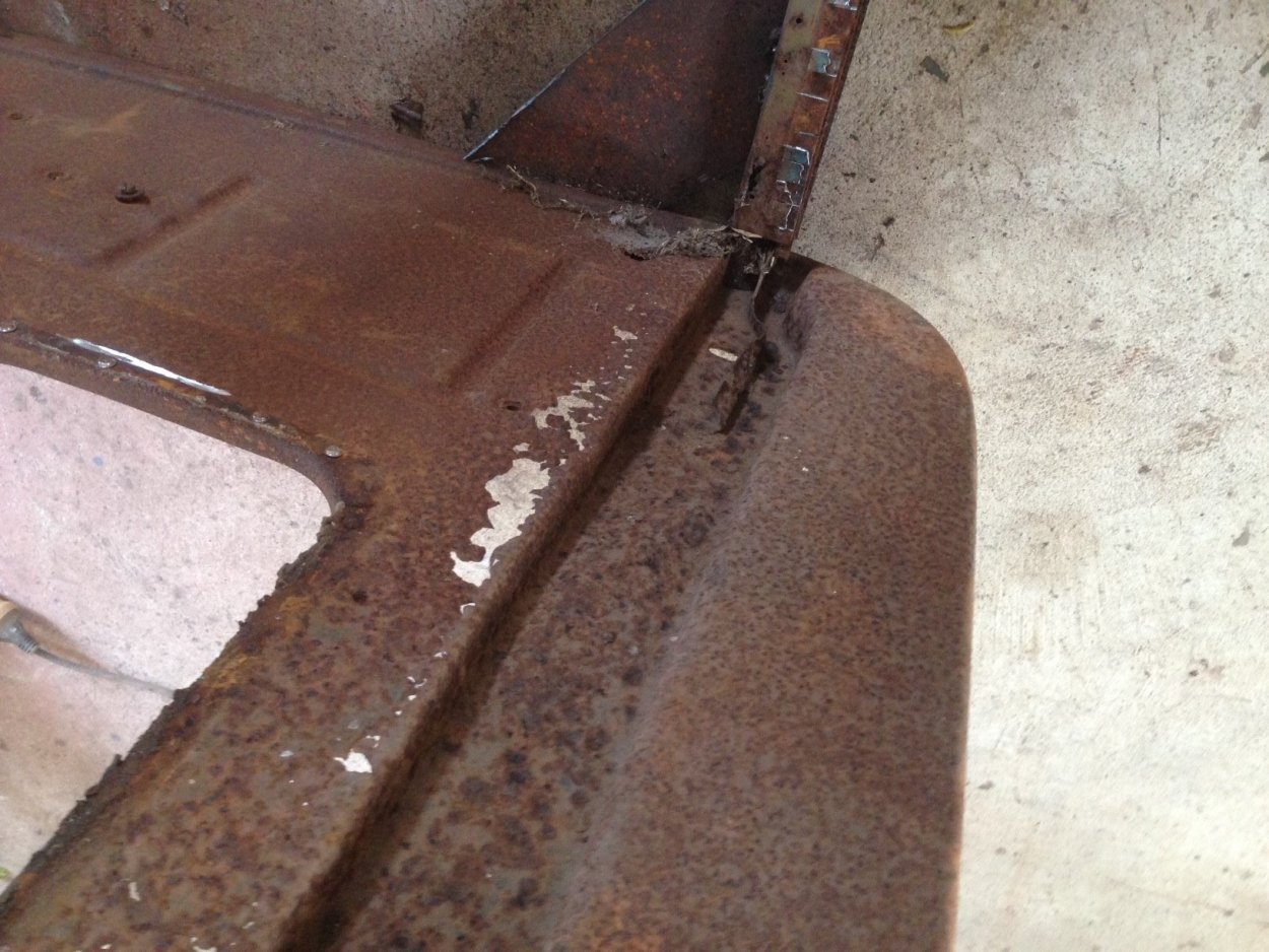

Comparing the two floors revealed the part cab to have the best transmission cover and the best floor would come from using the part cab front and the ambo rear and grafted the two together as well as adding some new metal where the rust on both floors was equally bad.
