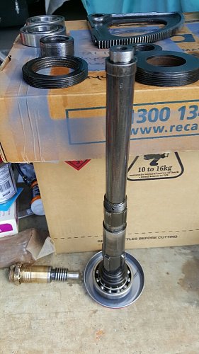

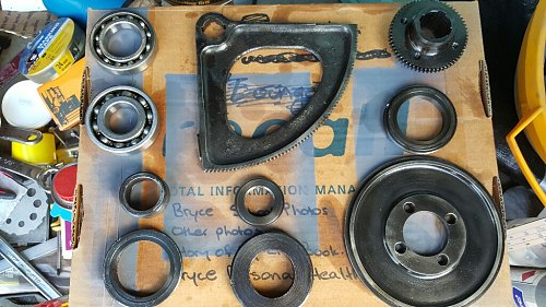

Only a few parts yet to be cleaned and inspected, before undercoating.
In the end, I decided against leaving the large brass part unpainted. It would have been a HUGE job to remove every trace of paint and tarnish from every flaw and crevice of the casting. Paint stripper wasn't much help either. The original color, which was surprisingly light in shade, would hardly soften in places, but repeated applications got the most of it. Abrasion with a small wire brush got the remainder.
The main shaft is in excellent condition, and required little more than a modest degreasing. All 4 main bearings, likewise! If they were holding a wheel stub in place, I might consider replacing them, but as they will have little actual work to do, originals will be fine for that light duty work.
