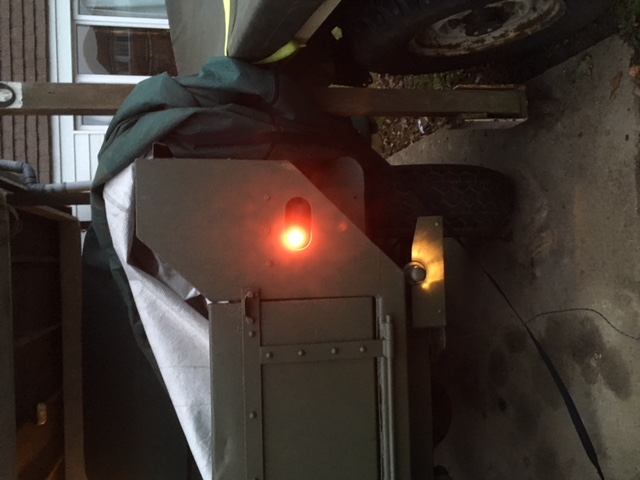

The other little job turned out to be a 'mare! I fitted the rear light lenses, all good until I smelt burning. The tail light had started to melt! I realised the error of my ways - a 12v conversion means the bulbs are much hotter!! I challenged my lad to make me some new red lenses using a laser cutter. He bought them home today, absolutely brilliant! He's done a superb job. I've decided to used LED bulbs in the rear lights as they run much cooler. If anyone else needs red lenses for their rubbolites let me know, my lad, Zac, can make them.
