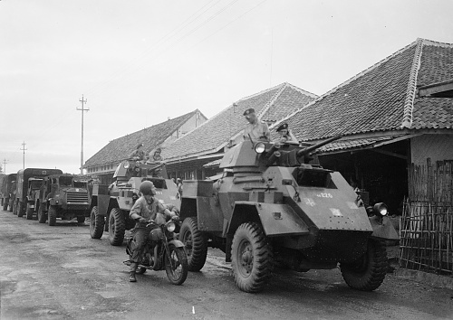

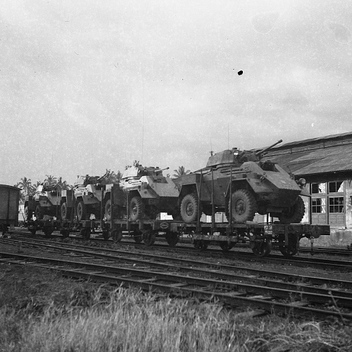

From my Made in Canada website: Car, Armoured, Mark I, Fox I:
Shortly after WW2, when the Netherlands were trying to prevent Indonesia becoming independent, the Humber Mk.IV Armoured Car was the backbone of the Royal Netherlands Army's reconnaissance squadrons. When the supply of usable Humber Mk.IV's ran out, 39 Foxes were acquired from the vehicle dump at Deelen. During October 1946 Machinefabriek Wilton Fijenoord in Rotterdam fitted a Humber turret to a Fox hull. The firing trials on 7 November 1946 were very successful so it was decided to convert 34 Foxes. The advantage of the Humber's 37 mm main gun was that uniformity in armament was retained. Also, the Fox's GMC engine was easier to maintain as the RNLA used large numbers of GMC trucks with the same powerplant. The Humfox armoured cars were shipped to Indonesia were they were used by the recce squadrons in conjunction with Ford Lynx or Humber Mk.III Reconnaissance Cars.
After the independence of Indonesia, the RNLA handed over much equipment. It is not known if and for how long the Indonesian Army used Humfoxes. Also, it is possible that a number of them were shipped back to the Netherlands. On 17 March 1951 the material overview still listed 14 "armoured cars, GMC, closed, with turret, Foxhound". It is unclear whether these were Fox or Humfox armoured cars.
Tour through West Java by the Huzaren van Boreel regiment, 1948:
