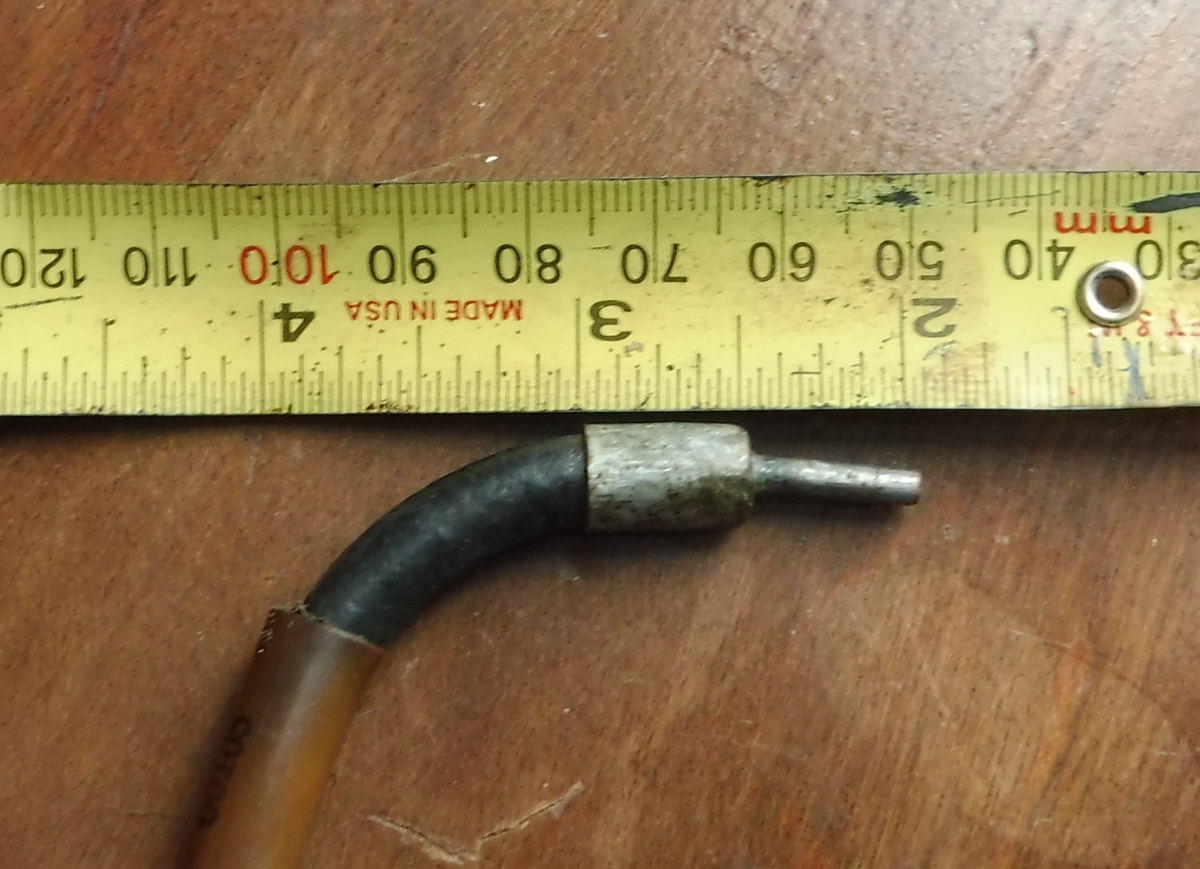

Ah, what do the ends look like, please?
The exact length would help (for possible forgery purposes) too.
(Not that I have a WS52 nor am I likely to get one!)

Metal ends are 1/2" at 5/16" diameter and 9/16" at 1/8" diameter (1-1/16" total, and both ends are the same). Cable is 1/4" diameter 23-3/8" long between the backs of the metal end plugs, so overall cable length tip to metal tip is 23-3/8" plus 1-1/16" plus the other 1-1/16" or 25-1/2" tip to tip.
