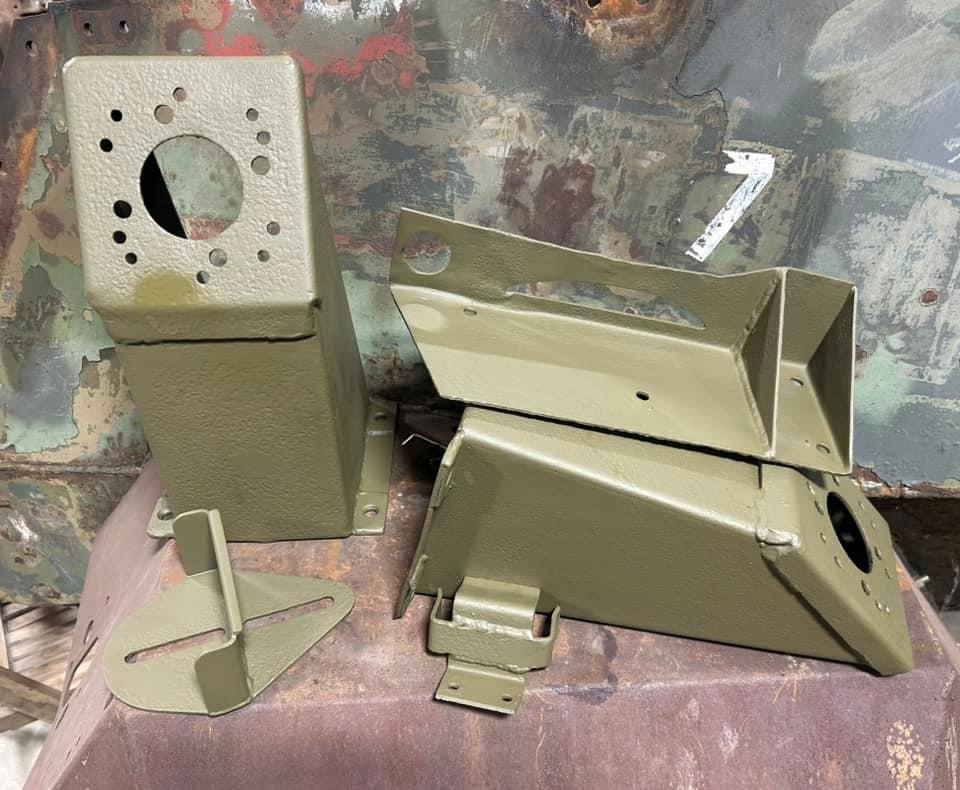

Really enjoying this citric acid bath for rust removal and now also a caustic bath for paint removal. These parts had some serious heavy rusting to clean off. It would have taken a few hours of work in the blasting cabinet. Instead I left the parts soaking over night and they came out pretty clean. A few spots still had the heavy post war Dutch paint. However the needle scaler made short work. The caustic bath was made up using Purple Zep cleaner. With the heater in that tub the paint is simply melting off the seats. Tomorrow morning I should be able to hose off the remaining paint and then leave them in the citric bath for 24hrs. The stuff will then be ready for painting. The finished up parts comprised of the two antenna mounts, shovel handle bracket, pick axe handle bracket and combination bracket that held the shovel blade, pry bar end and pick axe handle.
