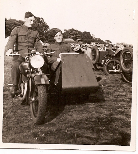

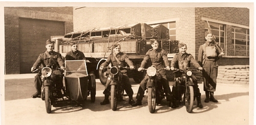

Default British bikes with sidecar
Any one know what the British bikes are
Name:	bike sidecar.jpg email.jpg
Name:	bike sidecar 2.jpg email.jpg
Original Photos from my collection
Keith
Old 13-05-08, 01:08
Hi Keith,
The lower photo is definitely military, a Norton Big 4 633cc with sidecar wheel drive by looks of it.
The upper photo, I think, is probably a Home Guard unit. The lorry looks to be civilian, outside of a factory or works. The assortment of motorcycles could be impressed or owned by the riders.
Old 13-05-08, 02:07
Rich Payne Rich Payne is offline
Join Date: Mar 2006
Location: Limburg, Belgium
Posts: 279
As Richard says, nothing very WD about the machines in the top picture. I think that I can see a star on the fuel tank of the second bike from the right which usually suggests BSA to me. The bikes don't seem to have black-out lighting and the riders have battledress which seems a little conflicting in terms of dating.
The Norton Big 4 picture is an interesting one. There are quite a number there and they look to be fairly new and still finished in pre-war Service Green. The riders are wearing Service Dress. The first proper batch of these was delivered in May 1939 so the picture was presumably taken during the summer of 1939. As far as I have been able to tell, there were only two fully equipped Motorcycle Battalions with Big 4s at the outbreak of war, 4th Royal Northumberland Fusiliers who fought at Arras with 50th Div and the Territorials of 1st Queen Victorias Rifles who had the misfortune to be sent to Calais (without their motorcycles).
Would I be correct in thinking, from the colour of their stripes and buttons that they are from a Rifle Regiment ? If so, probably 1 QVR.
Rich

Posts: 294
Smile British bikes with sidecar
Thanks Rich,
One of the troops is from the Kings Royal Rifle Corps.
Cpl H Challen Army number 6607935 he ended up a Colour/Sgt D.Coy 2/KRRC.
Keith
