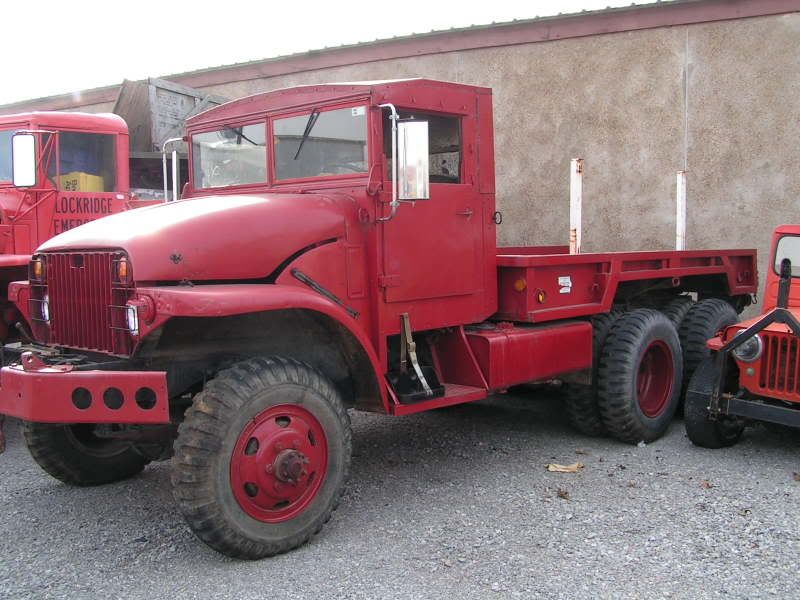

Originally Posted by Gordons View Post
Terry this looks like an F60 series truck, are those 20 " tires and rims ?
The rear bumpers look odd also ?
there is no such thing as an F60A truck. This is one of the smaller trucks with 20inch wheels fitted. The rear bumpers look like GMC-CCKW ones and the rear deck does look odd as though it is a highly modified replacement.
Terry is the cargo box original ? Or is this off something else?
It is the cargo box off an M135 2.5 ton truck. Gordon Yeo also has one on his C15A. I saw it last year on his truck, and it really looks the part, especially when one removes the diagonal bars.

HI Hanno,
I think you win look like the one on the Deuce and if you look on the back no place for the spear tire

Hello
I have seen the wheels with tires which dimension seems to be 1050 X 16
So I think that your truck is a FORD CANADA F22.
These trucks , builded at the end of the war , were intended to be used as artillery tractor. They used some parts of FORD CANADA F60L. The radiator should be oversized and a little portion of sphere was often over the hood.
I join a pic of F22 seen in NORMANDY il 1994 with a 1C2 body.
regards Serge
