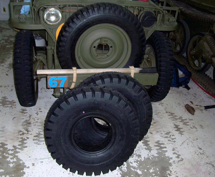

I ended up ordering the pattern I'd posted about that Wallace Tire could get from the Specialty Tires of America company. They came in today via UPS with new flaps and tubes that I needed. The tread is really similar to the $50 Firestone tire that Coleman's shows listed. Figures something that looks the same would turn up for less money the day mine get delivered but that's how my luck seems to run
These were $135.91 and are 10 ply 7.50x10 made for a 5.5" wide rim. My towed mortar technically has 5" wide rims but I'm told there won't be an issue. Measured the actual rubber and its less than 5" wide at the bead so should bolt together with no problem and still have some room to expand when aired up.
My hard parts are being stripped this week but it might be awhile before I can get them painted and then mount the rubber. I'll update shots at that time though to show how they turned out.

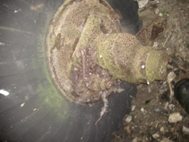

I have just found these cut off axles and wheels in a farm junk area - they have the lugs on the rims as per gun rims , the tyres size is 10x8.25 . sorry for the poor quality of the photos.
If you are selling these I would be interested but only if the tyres are not cracked.

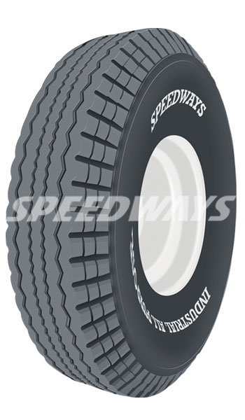

Speedways makes an "INDUSTRIAL ALL PURPOSE" tyre in 8.25-10 Size in 10, 14 Ply Rating.
See http://www.speedwaystyres.com/traile...car-tyres.html

I just scrolled back to the top of this post and David's post nr4 shows Industrial All Purpose tyres with the same pattern but a different size.

Finally made the time to repaint the wheels for my towed mortar and got the new rubber mounted last night on my backyard deck. While still not a British wartime pattern, I'm much happier with them than I was with the aircraft balloon tyres I had. And I like them much more than a NDT U.S. pattern. Being a 10 ply, I probably won't ever notice if they are low on air pressure since the mortar is only around 5-cwt.

We got a break in the cold temps so I was able to get the rest of the towed mortar base painted and assembled. Two shots attached to show the final result of the modern tyres mounted on the 6-pdr pattern wheels.
Interestingly, the 4.2-inch towed base design first appeared in 1944. But the wheels and related parts used on my example must have come from unused or salvaged artillery parts as they are all 1942 and 1943 dated. I'd have thought that the military would have used up all of the earlier produced components and had more current (at the time) items when they began building the portable base plates.
When first produced in 1944, these would have used wheels like the ones pictured on the airborne 10-cwt trailer also seen in the shots. Then sometime in 1945 they went to the wider and slightly lower profile 6-pdr pattern.
