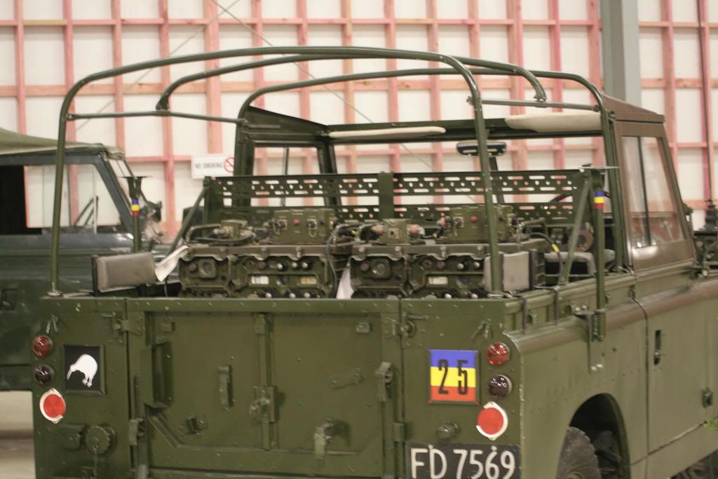

I guess it depends what era you wish the LR to depict Bruce.....
plenty of choices with comms kit....
C42/B47 C45/B48 and all the earlier Larx kit....
I saw a LWB in the Waiouru Museum storage sheds with a PRC77 and PRC47...
here is the Museums SWB FFR at a LR 60th event last year....
C42 & C45 with all the kit....
I have a ZC1 in my 1951 80", that is quite in keeping with the era.

Thanks for the details Brent and Mal.
I have the 109' Long wheelbase version of the NZ 2A Landrover FFR. It's a bit of a basket case but I have a lot of the sigs gear for the fitout as well.
A friend in the local RSL is ex NZ Army and used to drive them. He gave me a set of NZ RSL stickers etc on Anzac day as an incentive to complete the rebuild. Very kind of him.
Nice pic Brent and a bit of encouragement.

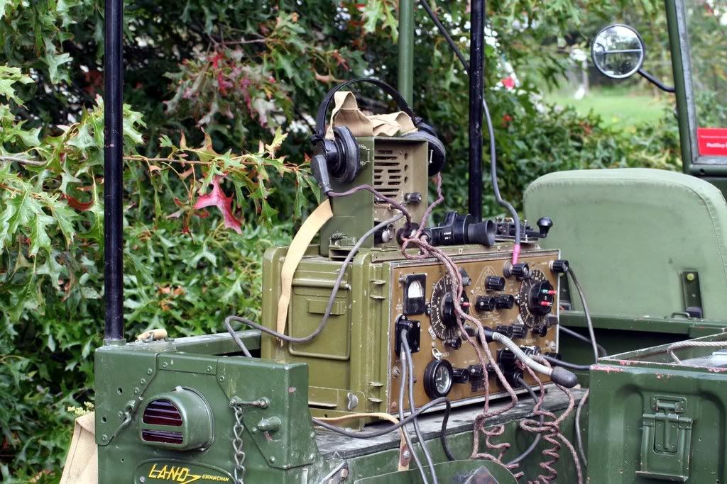

there again you may want to go this way FFR of now defunct !st Batt KOSB my own local Regiment with HQ here in berwick on Tweed at the first ever purpose built Barracks in the UK( here endith the lesson) regards malcolm

Mal - that's a nice C13 you have mounted in the rear there. Did they not use the standard Larkspur series mounting rack and mounting table in that unit?

Phillip...they couldnt source one so the chippy was called in and made a "local unit modification" regards malcolm
