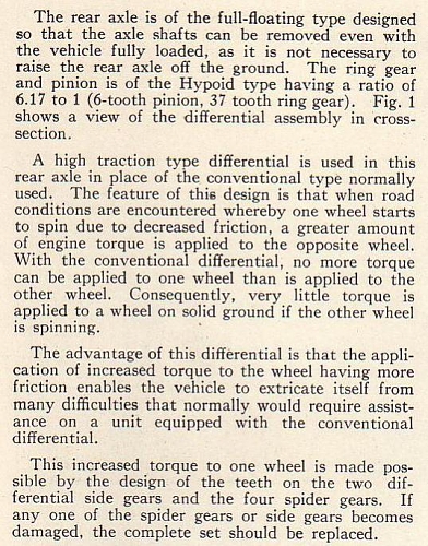

Sorry to leave you hanging in the lurch like that, John, but I had hoped a Chev afficianado might have stepped in here while I was searching for my MB-C1.
The following is an excerpt from the Chev Maint manual. As far as I know, the C15 is the only CMP, MCP or even WW2 2WD to have a traction enhanced differential fitted as standard. The Manual does provide a description and diagram of the unit, but it is not detailed enough to ID the mechanism. While not a Locking Diff as such, it appears to be a type of LSD, but of which type I don't know. Early LSDs were produced by Eaton as Posi-Locks, and Gov-Locks for smaller applications, but the CMP diff is in a sort of in-between zone between light-duty car diffs and heavy-duty truck/earthmoving diffs, and I don't know what applications were provided for in the early LSDs. It would have to rate as one of the earliest production installations of an LSD in a road-oriented vehicle.

The last paragraph inplies a Borg Warner type lsd,(as fitted to 70's and 80's Holdens and Falcons) where the side gears, under load, act to lock the side gear to the carrier.The side gear is angled at the back, and wedges into a matching taper in the housing.
Incidentally the Detroit Locker was fitted in the 6x6 Dodge T223 during ww2, and as I understand would still drive one side, when the half shaft on the other side was broken.
