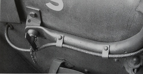

My jeep has the hole for the windshield wiper wire and even the clips for the wire up the windshield frame tube - but sadly no wiper motor.

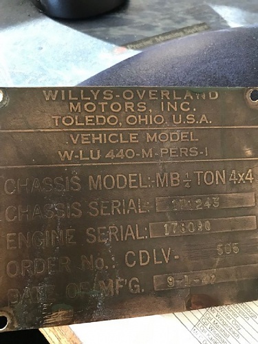

Thanks for all the good info Eric. Sadly the tub is new so I am still searching for and collecting bits and pieces for the Jeep to truly kit it out with all the CDN contract stuff. Here is a picture of the original data plate. If you have anymore information on this Jeep it would be much appreciated. Would you know what WD hood number this jeep would have had? I might as well redo the hood with the proper number and larger star.

Hello TJ
The closest WD number I could find is CM4233328 which was on SN173194
In Canada SN 171224 had DND number 35-804
" 171202 " 61-438
These numbers are not related to the vehicles SN and were not assigned in chronological order pertaining to the vehicles serial number.
There are 2 styles of electric wiper motors. One with 1 power plug while the other has two. Either one will work. The proper one has been debated. There is no doubt the single plug is contract 241/242 but there is a possibility that the 2 plug was used on contract 505 as the 2 parts manuals show different part numbers. These were also used on other vehicles, so you must check the shaft length, the wiper arm attachment style and the voltage.

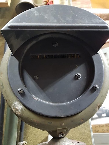

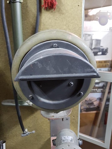

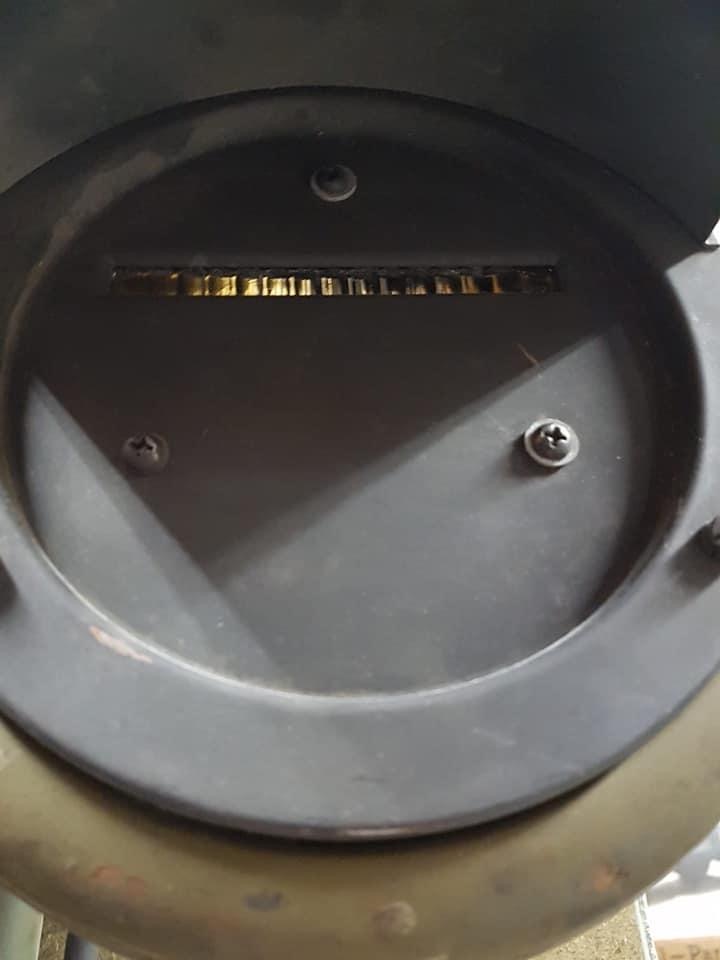

Default blackout headlight
This is the same blackout headlight, correct?

Hello Hanno
Something looks wrong with that light. It looks like it is inside out.

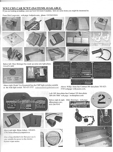

Those lights are really hard to find now. Brian Asbury use to have them NOS.
The wipers are even harder to find. E-bay is most likely the best chance or G503. The proper wiper will not be cheap. Dirk Leegwater had some brackets and arms at one point for them.
The WD number can be a roll of the dice. When they were assembled in the UK they were initially assigned a CMD number. They might have sat there for a short while before being assigned to a unit. Only once assigned to a unit were they given a WD number. They just took what they had and assigned it. i.e. 4 cars 5cwt to Black Watch of Canada. Then they assigned 5 WD numbers in sequence.
Most of my research was in house looking at actual documents or Microfiche. The Microfiche is now on line.
Hello Eric,
Having seen the picture you posted above makes clear the headlight I posted pictures of, is a different light altogether.
The black out mask may be the same, used inside out, but the headlight bucket is clearly a different one.
Thanks for clearing that up.

Just a note that my email address in the flier of parts suppliers that Eric posted is an old email and will not work. I can always be contacted via PM on this forum (BCA).
... Brian
Old 22-04-20, 00:11
Eric B Eric B is offline
Posts: 580
Default refernce page only
Yes the page from CMP Magazine is dated and was more of a reference.
Eric
