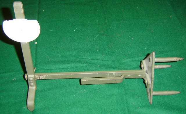

Can anyone help ,me with either one or both a picture of the Vickers Aiming post that was issued with the carriers,in the manual that I have its described as Post.Aiming,M.G Mk 111.or the dimensions of one, I have a rough idea of what they look like but would like the real thing or at least an excellent copy,

http://www.vickersmachinegun.org.uk/acc-sightingkit.htm

Hi Rob this is what I was asking about thanks Ron

Default Vickers Aiming post
Hi Ron,
Is it on here?

Hi Darryl,
Good to here from you, you live in a great spot, the bottom end of the South Island is my favorite place in the world, I have spent many holidays hunting the Fiordlands in years gone by chasing Wapiti,
Anyway back to the my question, you are spot on the money. yes thats the item that I was asking about, is it original? or new manufacture,?

Hi Ron,
PM sent back to you. Probably done when the carrier was restored I'd say. Yes, the lower south island is a great spot. Lots of outdoor places for hunting etc. Let me know when you are next over.
