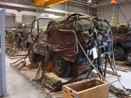

In the spirit of Airborne Iltis', while working at the Para Centre I took some pictures of the Aerial Delivery Iltis' which are still used as training aids. If my dad ever emails me the pictures I'll upload them here.
Richard Law

Here are the pics of the Iltis and M101.
Trailer:
Richard Law
