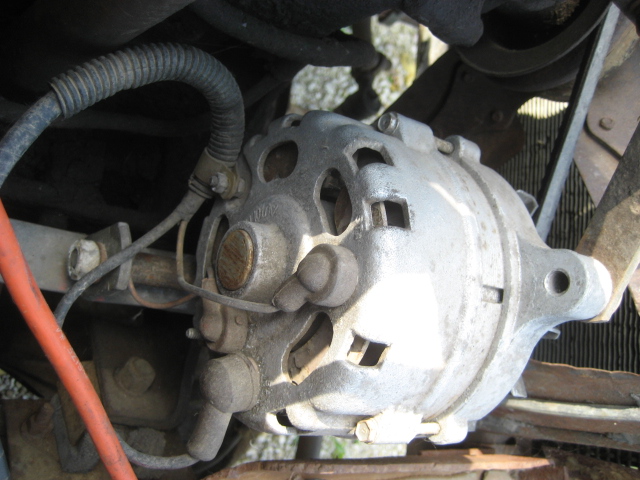

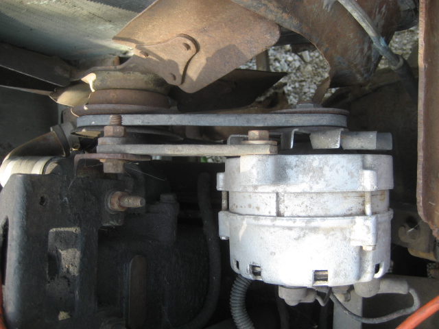

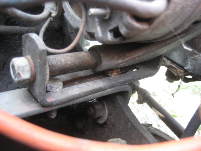

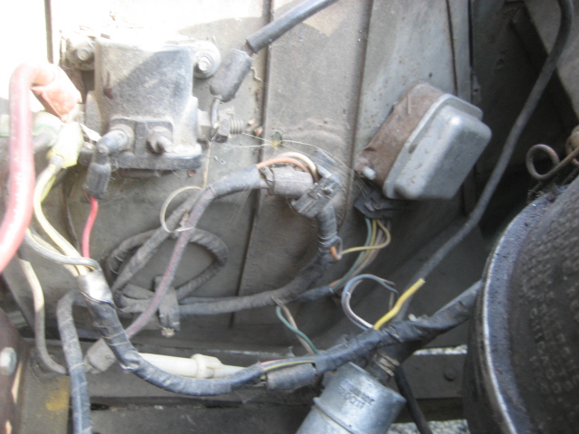

I bought a Ford GPW jeep last fall that had already been converted to 12 volts with an alternator fitted.The jeep sure starts nice but have not driven it much yet.One positive thing going to 12 volts is the fact that the headlights in 6 volt are drying up from what I have been told but the 12 volt ones are still available and reasonably priced.Here are some pictures of what I have in my jeep if it helps in any way;
I am glad you brought up this subject as I have to figure out myself what to do with the fuel guage to make it work on 12 volt system and anything else that has to be converted.
Regards,Derk.

Derk
Thank you for the update info and the pictures. I was wondering what type of alternator you have and if you had any modification made to install it in place of the large old 6 voly generator, The photo clearly shows how the alternator lines up with the water pump pulley, that was one thing I was wondering, how to line it all up, I also noted the fan belt looks as if it is not as wide as the original.
I supected starting would be better and I also think I will get better lighting for night driving. Could you advise the type/brand of alternator you have and also what type/brand 12 volt coil you have on your vehicle.

I will be able to take some pictures for you on the weekend when I get a chance to work on the jeep and post them for you.
Derk.

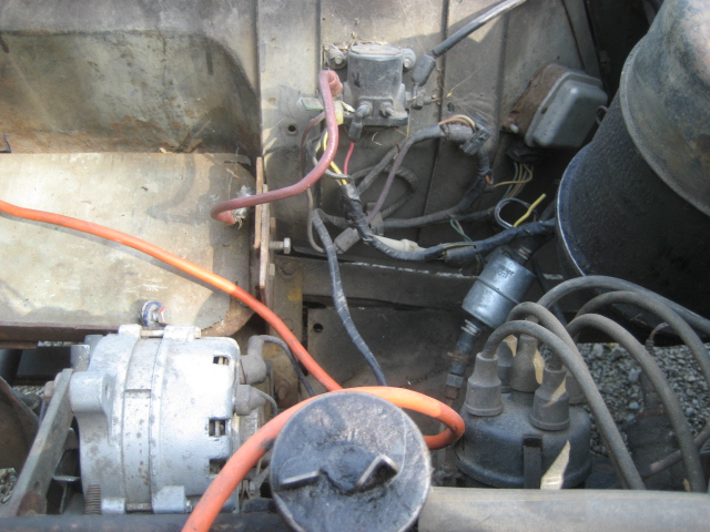

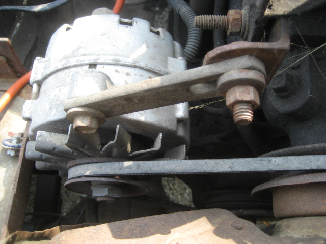

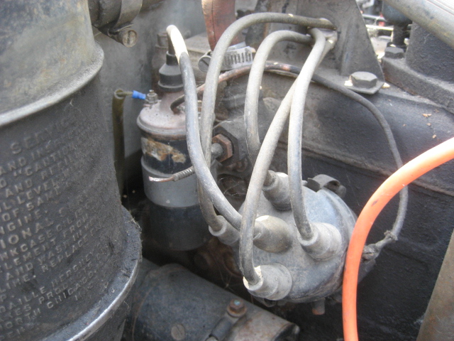

Hi Little Jo,
Sorry for the slow response,had a few projects on the go and haven't been at the jeep yet.I managed to take pictures of the 12 volt system that was in my jeep.The lower alternator bracket was made up to bolt onto the original generator lower bracket and the upper bracket is just a metal link to the block.The alternator is an Autolite but could not find any more markings on it.There is also a seperate regulator on the fender but my Dad looked at it and figures it shouldn't be needed as it should already have one in the alternator but says to leave it there if it works.Maybe the alternators built in regulator didn't work and they added one on? Then everything goes to the solenoid.The coil is just mounted beside the distributor.
I hope this helps and if there is anything else I can help with,let me know.Good luck with the project.
Derk.

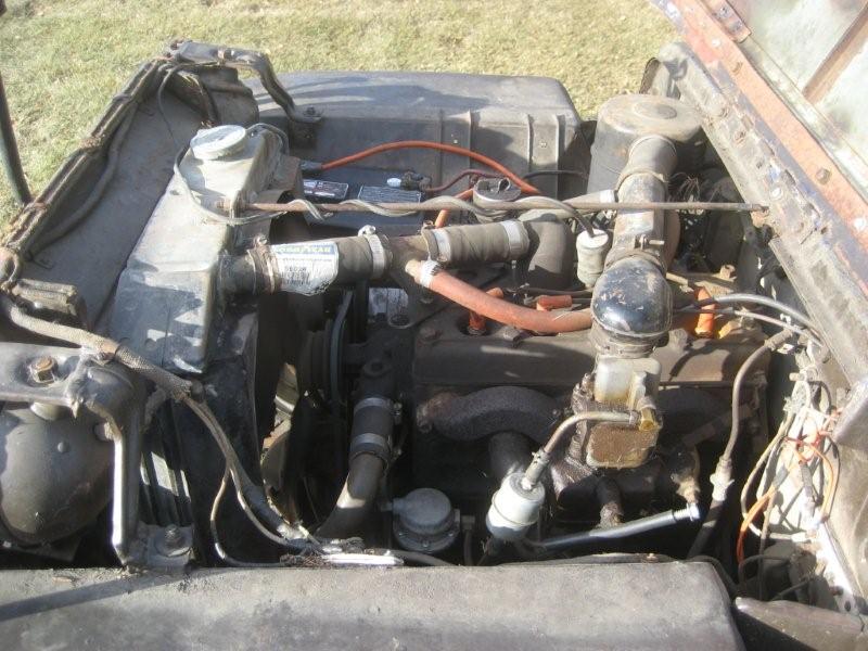

Thank you for the great site on 6 volt to 12 volt conversion. I have printed it off for reference when I start putting the MB Jeep back together again. The restoration is coming along fine and I appear to be on schedule as I would like to drive it to Corowa in March 2010.

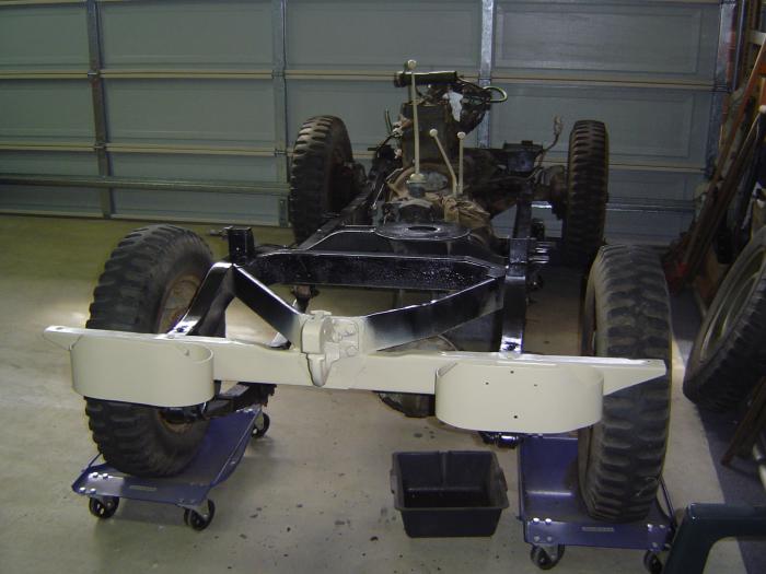

I have been impressed with the great advice I have been receiving from MLU members. I have enclosed a Photo of when Saleman Bob and I collected the Jeep and a current photo of where I am up to with the restoration as of today.
I am waiting for further parts to continue with the project. My aim is to paint the vehicle in LRDG colours.
Just for interest, my family immmigrated to Australia from Hilligom Holland in 1950 and I have visited Holland many times over the years.
