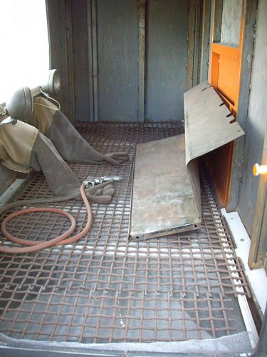

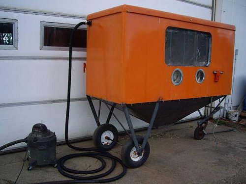

This truck sleeper was used to make a great sand blaster It is 32" wide x 84" long .It has a door on the end to put things in , a vent to let air in and you have to hook a shop vac up to the orther end .I made a hopper for the bottom to hold the sand or glass beads .I used a crusher screen to hold things on with a fine screen under it to catch the bigger particals of dirt .There is a trap door on the bottom for when you want to clean the sand when it gets too dirty Put a 1/4" plastic over the window then add some stickon sheets of plastic that can be changed when the wimdow gets hard to see through. I made two holders to which exter long gloves were added below the window .Mount a blaster gun in it and I hook that to my shop air compresser .85 lbs is enough pressure I put wheels on it so as to move it around the shop when not in use or, if more than one were to use it ,This is a super blaster for inside Very clean to work with George

Great setup! Looks like the only limitation is short arms.
