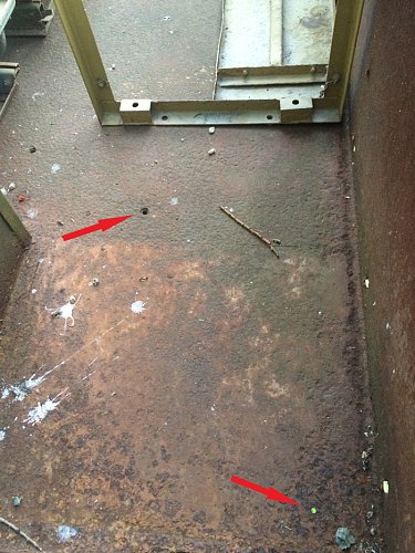

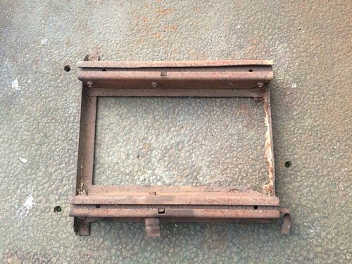

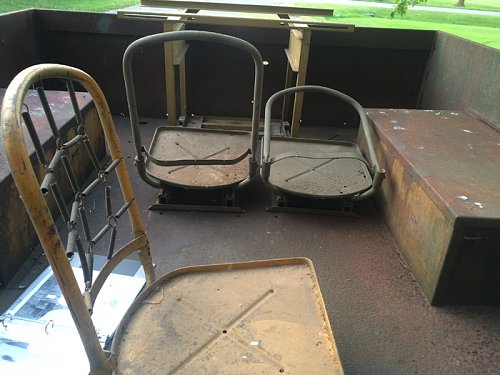

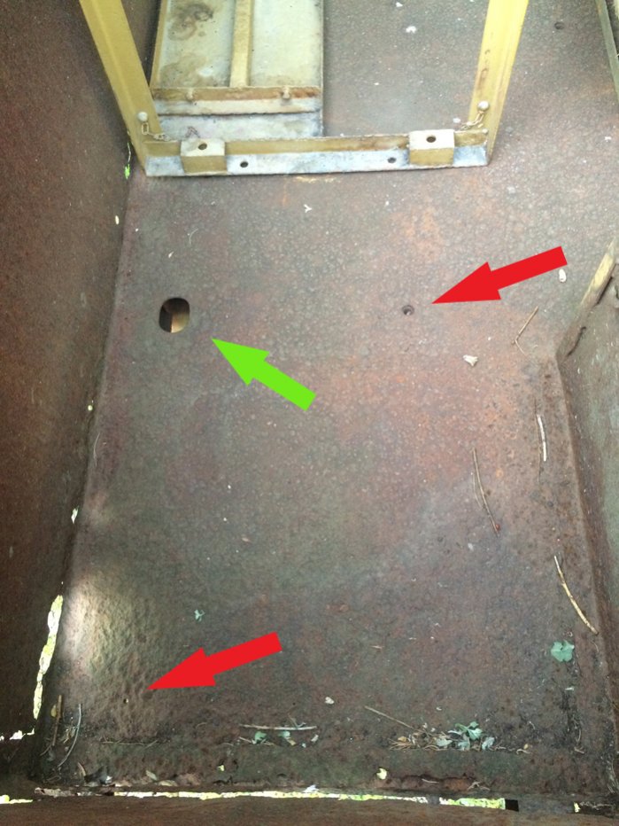

Old 24-05-17, 19:42
Posts: 4,187
Some more photos of the basic layout.
Another mystery is figuring out what the seat bases looked like. As you can see in the these two pictures the seats were mounted to the floor using three bolts. However these mounting points are outside of the normal CMP seat base. The manufactures part number is B340056
There were two battery trays on the truck with the following manufactures description and part numbers.
Stand Batteries Assy, RH #C38272
Stand Batteries Assy, LH #C38273
As you can see there is a couple mounting holes on the floor. Highlighted via the red arrows. On the left side is a larger oval hole. This was for the power cable from the Chorehorse to come up to the C5 charging board. It is highlighted with the green arrow.

Posts: 873
Hmmm...
Are the 3-hole seat mountings the tubular variety as used in the Wire-5 truck? (See other thread in the Restoration forum.)
The tray under the table may well be intended for 4 x 6V 85AH batteries since the aerial base 'cage' on the roof is for Aerial Base No.1 which was used with Wireless Set No.11 and that used 4 x 6V 85AH batteries for the vehicle fit. The tray may have been left in place when a WS19 was fitted.
I think the long bolt sticking out of the RHS of the table frame is definitely a mounting for a drum of telephone cable. The rectangular plate probably goes against the table frame to space the drum away from the flat bar (and any irregularity of the weld) and keep any rolled edge of the drum from fouling it. What is the spindle diameter and available length of the bar? It might take Reel, Cable, No.2 as used with the early control units, or the rather later split drum (Reel, Cable, No.4?) used with assault cable No.2 and later with D10. (It's also possibly a much later addition to the table.)
Chris.

Old 25-05-17, 01:53
Posts: 2,323
I don't think so. I just looked at the tube mount used to raise the seats in the Wire-5 box. They use 4 bolts in a pattern approximately 4" (wide) x 11" (front-back of seat) for mounting to the floor.

Posts: 4,187
Barry, thanks for the info on how the seats were mounted in the C15Ta. Im not sure this is how the Wire-3 had them though. When I tried out my seats in the box the other night, they seemed to match up to the wheel well height pretty closely while mounted on the original seat sliders. I have been told the seat mounts appeared similar to the 8cwt wireless truck seat mounts.
