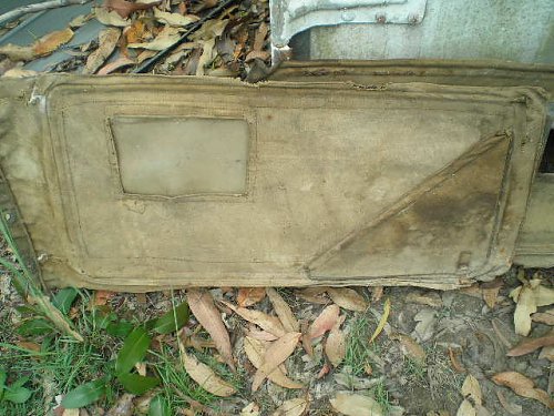

Does anyone have some good close up photos of the CMP side windows? I need to make some for a project I'm working on. I have a good set of frames but I need to make everything ese. Thanks

Here,s a couple to start with, old canvas and perspex.
macca C15 C15A
Old 05-05-11, 13:40
Default Are these of any use?
Can take better photos this weekend if its the design you have in mind
Old 05-05-11, 13:42
Default Third one
The third of Bob's pics is closest to a WW2 type. The first one is a 1959 pattern Aust Army edition.
http://oldcmp.net/Images/canvas/bandiaccess-4.jpg
This was fitted to a late production RAAF CMP.
Here's a different Aust WW2 pattern with a 1959 one for comparison:
http://oldcmp.net/Images/canvas/eucanvas.jpg
Yet another type on a C15
http://oldcmp.net/Images/Chevs/C15A/C15asunshine.jpg
And an Australian pattern 6 seat utility:
http://oldcmp.net/Images/official_pi...tility/top.jpg

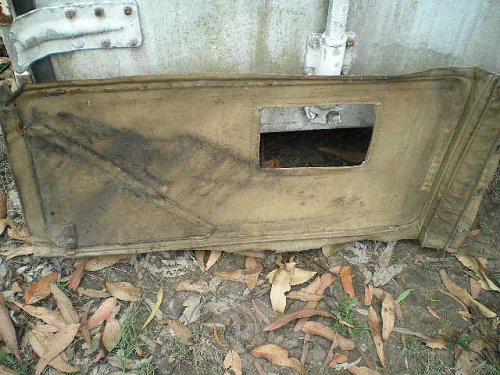

Default tops
Ian I made the perspex tops for every day use, easy to see out of, the canvas top [No 3 ] is made out of old railway tarp on an old frame for show time. Made a set for both Aussie door styles, takes about 2 hours per top. The perspex frames made from scratch. Made the bag for the tops out of the same tarp.
macca C15 C15A
Old 05-05-11, 16:18
Default Which Style of Windows
Hi Ian
From you question it is unclear which style or which country of assembly/manufacture, Make, or year CMP Pattern 11,12,13 you are trying to figure out the windows for. A picture of your frames would help nail all this down.
The responses so far have all been for the Australian style of window. There are also at least three styles of windows for CMPs as built in Canada.
Here is a link to some pictures posted in response to a similar question to me a few years ago http://www.canadianmilitarypattern.com/Posting.html
The picture below is of my 1945 HUP drivers side window though it also fits my 1941 Pattern 13 C60S. If this is the style you are looking for I'll gladly take more pictures of any detail you need.
