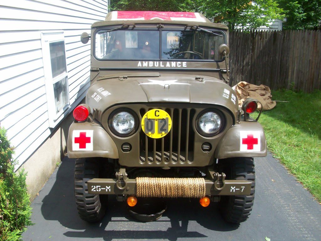

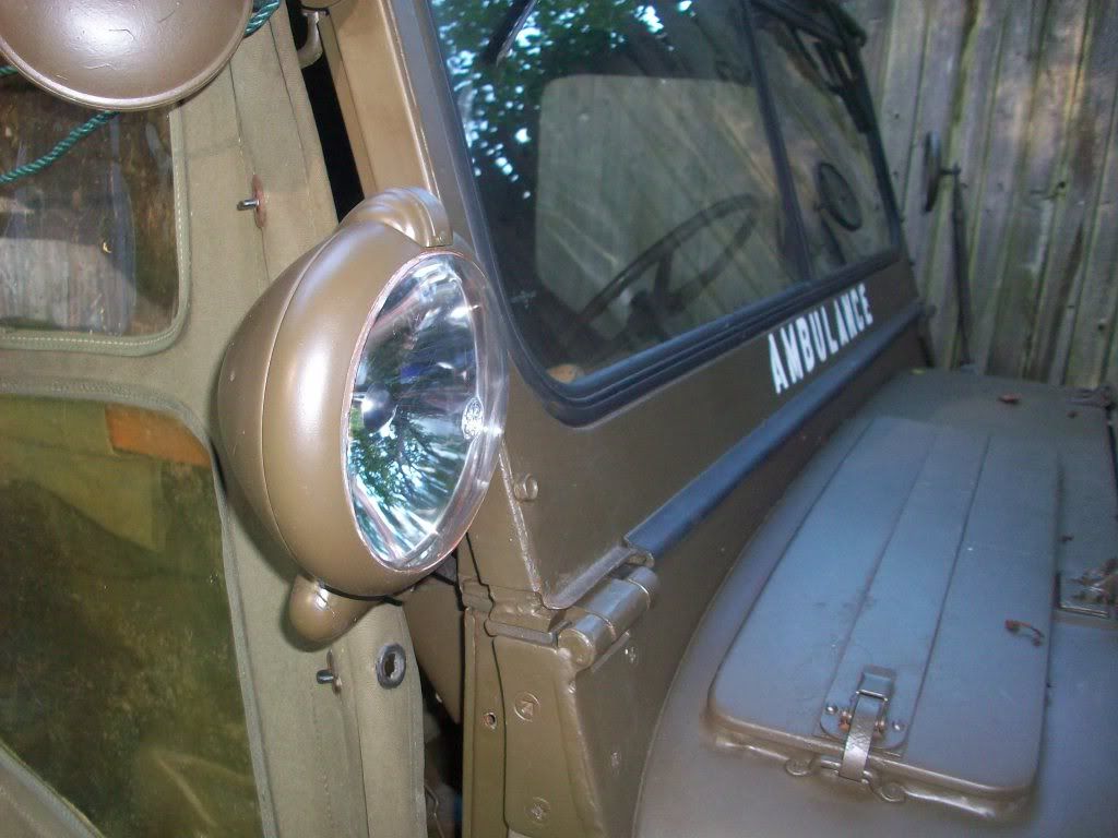

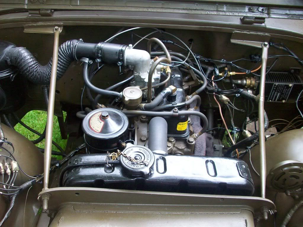

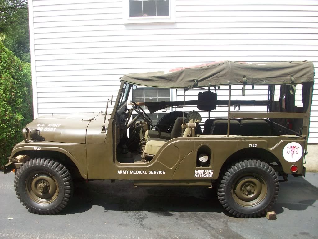

Default M170 pics
http://i170.photobucket.com/albums/u...Picture046.jpg
http://i170.photobucket.com/albums/u...Picture047.jpg
http://i170.photobucket.com/albums/u...cture064-1.jpg
Hurricane Engine pics and my new Spot light

Have to ask the battery cover you have on there ...i have a 1967 and it has the same style with the on clip very easy to open my 53 has the type with the 8 thumb busters...Did you change it out or is that a varient...? Hoping it is as it was as I would like to be able to swap it out. thanks and very inspiring for me to see such great examples!
Casey

This will provide you with the basic differences between your CDN and your CDN2, as built (meaning your CDN may have had some of the later modifications done to it while in service). As you can see, the thumbscrewed battery cover is original for a CDN, while the one with the clamp is original for a CDN2.
