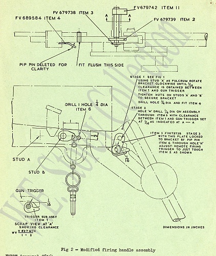

Default Modification Instruction - Mounting, Browning .30-In., No 8, Mk 1 - 1968
From V 627 Mod Instr No 76 Modification Instruction - Mounting, Browning .30-In., No 8, Mk 1.
Name:	Fig 2 - Modified Firing Handle Assembly.jpg
