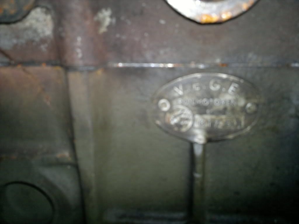

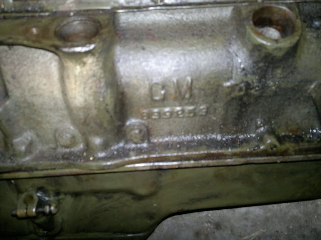

some photos of original engine casting numbers, apologies for some poor blurred images.

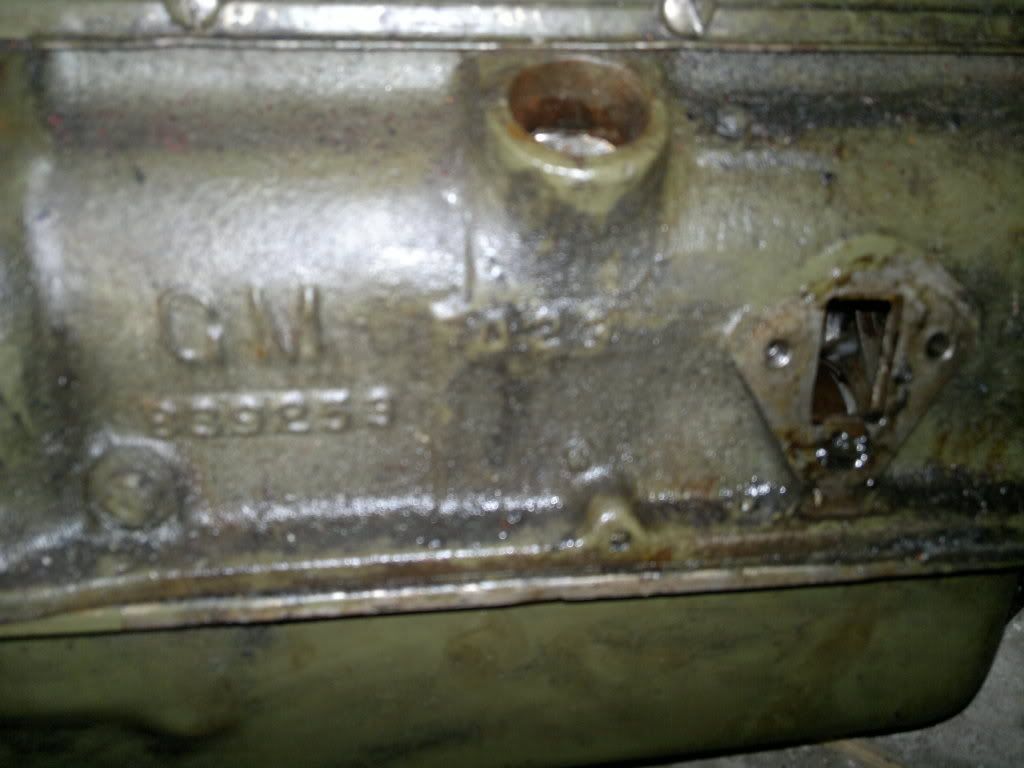

Casting numbers etc read GM 839253 A or 4-20-3 023
Engine Number PR 3885165 and the V.E.G.E. plate No 61751

Default Could you tell us a little more.
Hi Gary
Could you tell us again what you have tried to determine where the water leak is? The reason I ask is that there are not a whole lot of places to have an internal leak. May be some one will have a bright idea about a simple check and hopefully a fix.
Short of disassembling I have done air pressure test check on blocks and heads before taking them to the machine shop to be magnifluxed. In this way found the obviously junk blocks.
Besides it would be a shame to find a new block only to discover it was the head that was the culprit.
Now as to your block casting number 839253 it doesn't show up in any of my casting number source list all US lists, no surprise, now who in our little group has found the online list of Canadian GM casting numbers?

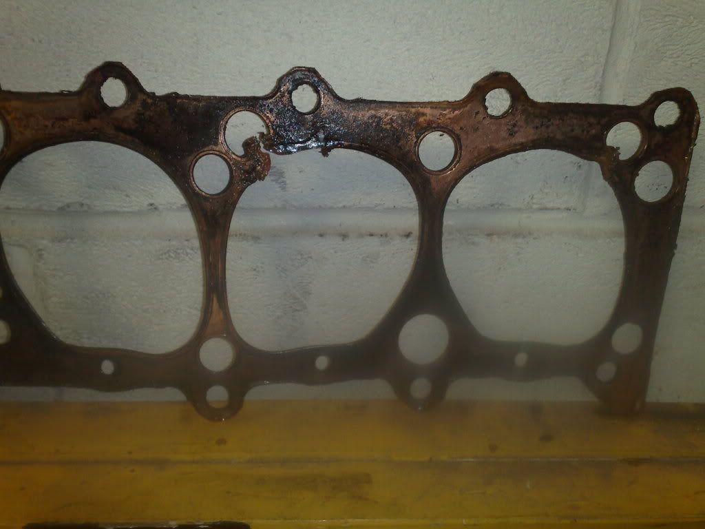

Old 10-04-12, 01:30
gazzaw gazzaw is offline
Gary
Join Date: Apr 2010
Location: Glasgow
Posts: 41
Thanks Phil

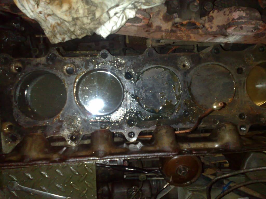

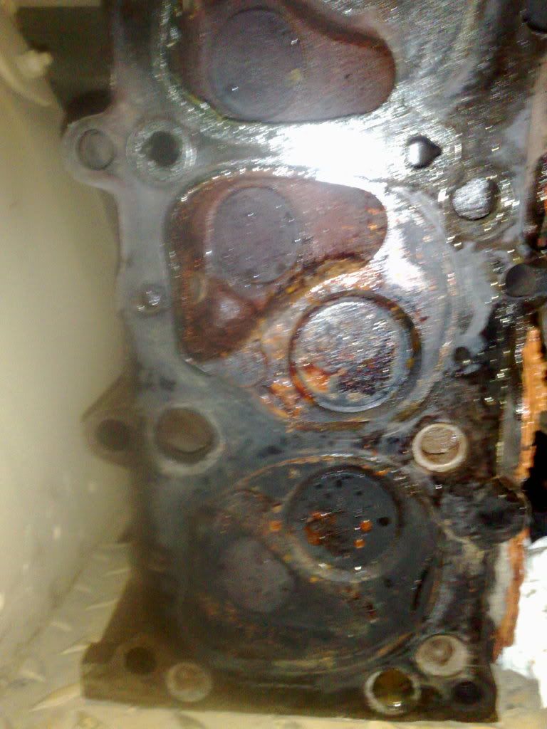

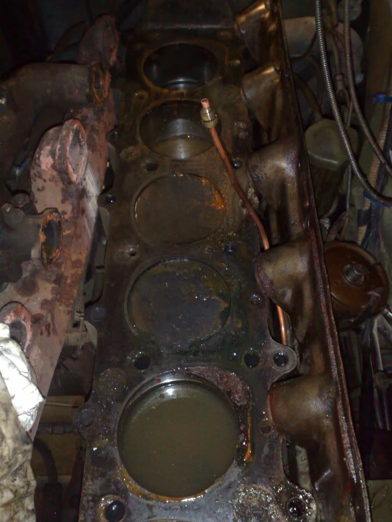

The pistons on this engine are flat headed so might it be US? Also photo of head and the head gasket where it shows damage in No 2 cylinder where water had originally been leaking from exhaust port. After refurb on head and refitting it was still leaking through port making us think it is block now.
Gary
Old 10-04-12, 01:57
Originally Posted by gazzaw View Post
Thanks Phil
Gary
[/IMG]
Hi Gary,
Seeing the gasket, and how you say the head has been faced, then if the head is still true, then i would suspect the block top face is a possible cause, looks like it may need facing, not unknown for this to happen.
Old 10-04-12, 15:00
Gary
Join Date: Apr 2010
Location: Glasgow
Posts: 41
Thanks Richard
Can only think it took a real roasting and will look at refacing face on block as well.
Gary

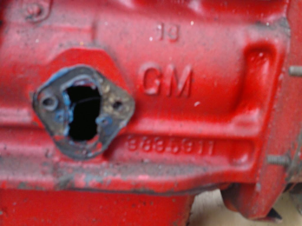

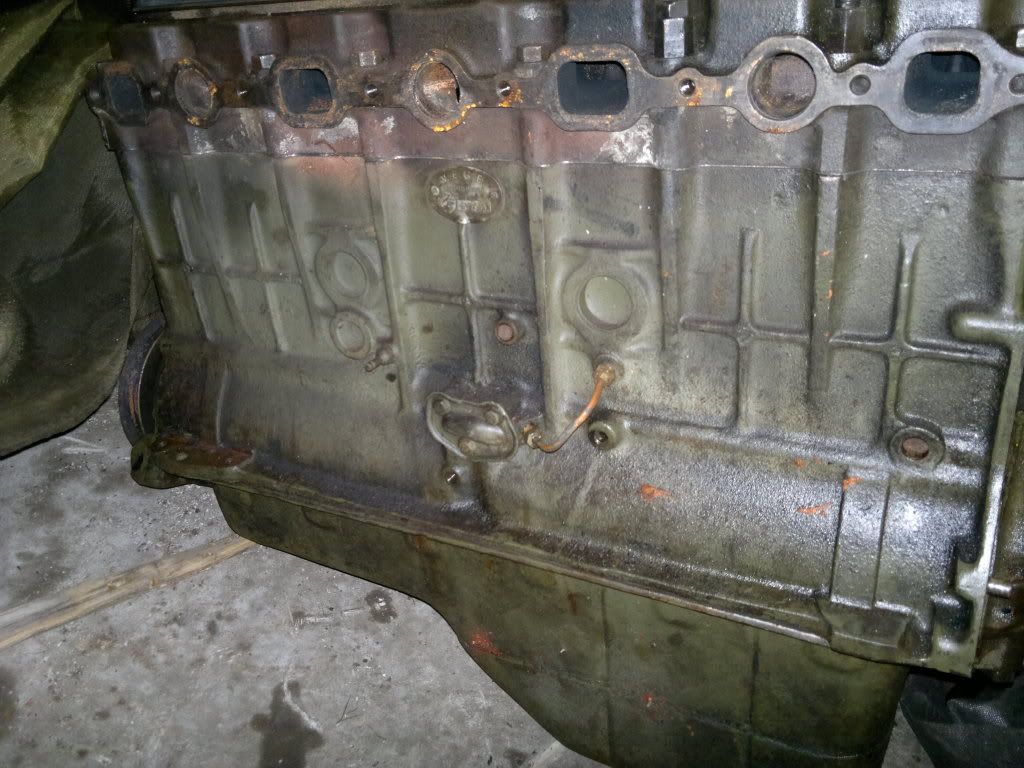

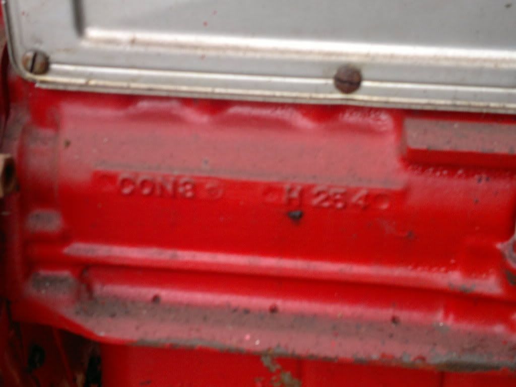

Any more info re the NOS heads as it might be prudent to get one and keep the old refurbed one as spare?
Below is photos of one of the engines we bought (from a distance on interweb) which was unsuitable - it has the fluid flywheel and rear mounting and we were prepared to redrill crankshaft but mounting casting all wrong. It was sold as a 235 but must be a different type as it is all wrong, better to repost it on Fleabay and sell it on I think. Info we got was the castings were right to swap over from the 216 to a 235 but now know different.

When you say that the flywheel on the 235 is wrong bolt pattern what do you mean. When I set up my 235 to 216 flywheel what was wrong was the diameter of the crank shaft to flywheel bolts 216 being slightly smaller, is this the problem you are hitting or is it a completely different bolt pattern?
