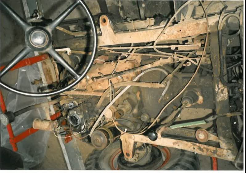

Years ago my brother bought an F60L with chassisnr. C-3980A.
this Ford Canada is still in pieces, but I wanna know more about it. Can anyone tell me more?

What would you like to know? Pictures of the truck would assist the fella's that can help you on this site,
Engine No is on the gearbox up in front of the gear shift.
Is it a Cab 11? 12? 13?.......... 14?

This Ford Canada has been disassembled in 1993. And it still is in that condition
All I got is an invoice of this vehicle to go on. I do know it's a cab 13.
I would be happy if one can say what year this Ford Canada was made.

Ok - at the top of the gearbox, in front of the plate that gives you access to the grease pipe down to the thrust bearing, is the engine number. You identify the third and fourth digits (in this case 43 on mine) subtract 1 and this gives you the year of build.
