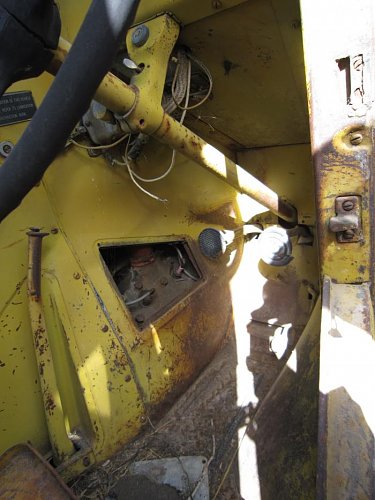

Default pictures
ID:	49075 These are both fords

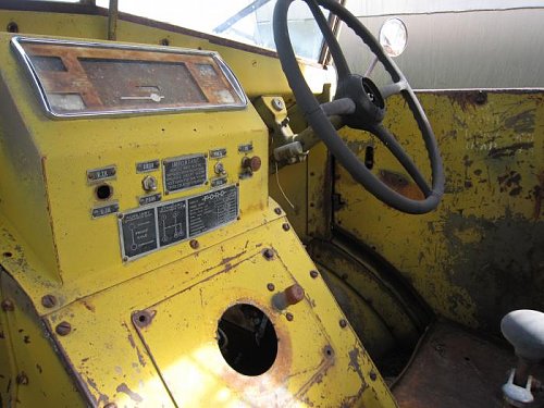

ID:	49076 the cab 11 has a lot of bolts holding every together

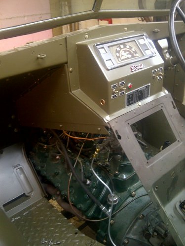

ID:	49077 the cab 12 has quick access with slots

Howard, any pictures will help, expecially Cab 12. I have almost finished Cab11, only the doghouse needs proper shape. The rest is about right I believe, though there are some little things which required compromises, not everything can be done perfectly in scale,molding technology has some limits, and wall thickness of the sheet metal in scale is always a big pain and headache to deal with. Cab 12 will be next, and any more pictures will help sooner or later, many thanks
Anthony, thank you, these are great and will help a lot to get my Ford Cab 11right

Originally Posted by ahleeds View Post
Attachment 49075 These are both fords
Attachment 49076 the cab 11 has a lot of bolts holding every together
Attachment 49077 the cab 12 has quick access with slots
Attachment 49078
Attachment 49079
Anthony.
I just figured out how to put pictures up this way ,,,wohoo
The cab 12 photos (bottom 3) are of an F8 (8cwt). Is this different to the 15cwt, 30cwt and 60cwt models?

The 8 cwt covers are the same as the 15 cwt ones for the same make and cab style. That should be clear as mud too!!
