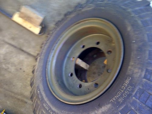

I've done this on the road with a johnson bar and a piece of pipe extension but much easier at home with an impact gun.

Nope. Just pulled the 2 half's apart like in the picture, put the wood block on one side, pulled the tube and liner out of the middle, moved the block to the other side and pull the tube and liner all the way out.
Reversing it I put the tube and liner in with the valve stem side first, clamped the valve stem loosely to the outside of its hole, pushed the tube and liner in half way round then remove the block and place it on the other side and finish feeding the tube and liner in the rest of the way.
i put some air in it at this point and move it around to settle it in place then take the block out and lay it all on its side. poke in from the middle with an old broom stick all the way round using the crowbar to lift the sides apart to save my digits. let all the air out and then make sure the half's coming together with a solid "ring" sound, metal to metal no pinched rubber .
Tighten up the red bolts to torque, blow the dirt off and touch up the red paint.
Never break the bead.

Old 06-07-12, 08:03

With flat # 2 I was killing myself trying to jack up the back of my loaded truck with the original screw jack. Had to be all authentic right. Garage pulled a floor jack over so they wouldn't have to bury me on the side of the road.
Flat #3 with my new bottle jack, didn't have enough travel so I blocked it up with the wood block then lowered and shoveled a load of gravel under the jack and lifted it clear.
I now have a bigger bottle jack with enough travel to lift the truck up from rim to a fully inflated tire.
Tubes, that cheep Chinese tube was only half the weight of a decent North American tube!
Put a dab of grease on the threads of the red nuts it will save you grief and some sweat if you are doing this without an impact gun.
Remember your right nuts from your left nuts!!
If you hear the air-brake hose let go and you hear that escaping high pressure air-hose... remember very quickly you don't have air-bakes and get your speed down as fast as you can. It will take all your strength to drive strait at 1 mph to get to a safe place but you'll end up in the bush's or worse if you ignore that sound.

When you are originally restoring your CMP rims take the time to carefully clean the inside of the rim to bare metal and paint with high gloss paint.
I have used POR 15 glossy black after sandblasting....... used regular tire shop tire lub snotty stuff on the bead........ removing a tire now is relatively easy....and so is the installation...... all in the anticipation of having to remove them like Harry pointed out.... a little zinc based Never Sieze on the studs is a blessing month later on the side of the road.
Old 10-07-12, 06:37
Location: Burnaby B.C. Canada
Posts: 1,130
Default You don't have to break the bead...
... to fix a flat. So a good clean rim to start and while I didn't put any grease on the 2 mating surfaces when I put them together the first time that might be a good idea too.
