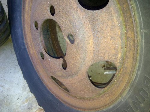

While I was cleaning up the wheels for the trailer I found the split ring to be too wide, about 1 1/2 wider than the other non split ring. So thanks to Rob love I have a safety ring rim to closely match the Rim i think is original.
I went and dug out the "spare" that came with the trailer that was damaged beyond repair, see for yourself i don't know how you could do this.

By the way that's a Dunlap Trak Grip
Maybe they didn't figure out the left hand thread!

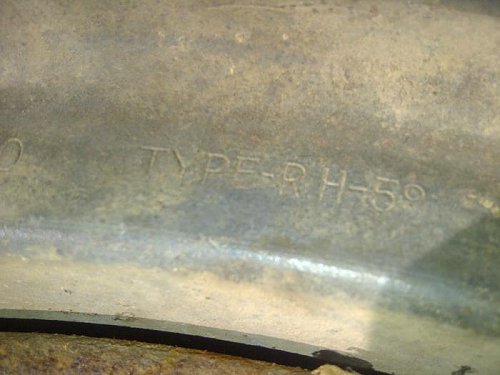

Anyways I found some info stamped on the rim, 3 51 K 20X6.0 type-RH-5• Patent applied for etc. The little dot beside the five is a small o signifying degree.

Seems to signify 5 degree rims, Ford, commercial pattern wheels....
I thought that was a British/Canadian thing only on 16 inch rims?
Or are these 51 dated as in the first numbers?

My understanding is that RH-5 is a particular design of split rim. Some people consider them particularly dangerous.
A couple of links from stovebolt.com:
http://www.stovebolt.com/techtips/wh...dd_catalog.jpg
http://www.stovebolt.com/techtips/wheels/
http://www.stovebolt.com/ubbthreads/...&Number=632556
I have seen negative comments on the safety of the RH-5 design (compared to other two or three part rims that are reasonably safe if properly treated) in several other places as well.

Grant: Those are some great links and answer a lot of questions. What I thought was drop center rims are actually going to be those deadly RH5 rims. Luckily, between the pair of trucks, I think I only have one or two so they will be weeded out during the restoration.
I consider all the multipiece rims as deadly, as I have seen the tremendous force from when they separate. They will bend 3 inch tubing, and knock a 200 pound man clean across the room. When filling any multi piece rim, make sure you have the rim secured. You can wrap a chain around the tire and rim through the center hole, or put the rim underneath the hoist or under the hull of your bren gun carrier. Always use one of those air chucks that clip on and with a long hose to the controller valve so you are away from the tire. Princess auto sells a short version of them, but I believe Milton makes the correct version. Yes, it's expensive, but even at $75 it's still cheaper than having the bone exposed in your hand or head when a tire lets go without warning.
I blew a small 16" mule tire at 40 pounds and it gave me a new respect for the forces involved. I was also present when an AVGP rim blew, at full pressure just as my guy was about to reach in to the cage to disconnect the hose. And during my last few months in the CF, I witnessed the aftermath of the worst case scenario when one of the guys at work did not use the cage at all, and was right at the tire trying to install the valve at an unknown pressure when the rim separated.
We all like to save a buck or a minute here and there where we can, but take my word for it, the gamble involved with not having the right tire chuck and not securing the tire while filling is a very high stake bet.

Interesting reading about the RH 5º wheels. They are surely the original tires for the trailer but now I question using them?
Old 26-09-12, 18:11
Posts: 7,623
Beyond their original safety concerns, add 70 years of wear and corrosion, and possible damage from occasional dis-assembly. Mine will become vehicle stands.

On reflection today,( and after going outside to see how many of these rims I really had), I think I would have to re-evaluate this earlier assessment.
If the rims are blasted clean, do not show any signs of damage, wear or corrosion, then why not re-use them, taking into account the safety requirements during filling. Many of them have lasted over half a century, and if they pass inspection now and are properly preserved, there is no reason they can't last another 100 years.
I found this style of rim on both my 1956 firetrucks, adding another 12 more of these rims to the total of 14 in the yard.

My first meeting with these rims was in the middle fifties. It took us two days to dismantle one even with a manual.
Even though they are easy to assemble i wont use them as i take pity on the bloke who will have to dismantle it later.
The scrappy will buy them.

Back in the seventies a friend's father had a septic tank pumping business. He purchased a used but very good condition 1961 GMC truck and installed a vacuum tank on the truck to pump septic tanks. The very first time he loaded the truck the right rear inner wheel blew apart. The wheel wasn't rusty and when examined the folded lip that held the wheel together simply straightened out and let the wheel separate. He purchased six new wheels of the lock ring design to replace the original wheels. The tire guy said that it was common for the centre split wheels to blow apart if the vehicle was overloaded! The tire size was 8:25-20. When looking at the design of the wheel you will realize that the wheel actually only locks together on about two thirds of the diameter.
I personally would not use them.
