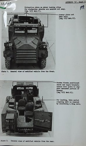

Modifications for Hamilcar Glider:
Hope this is of interest
Tim

The material is excellent - not what I was expecting or hoping for though - but it gives a detailed clear fit out for the WS19HP and WS52 radio sets and the modifications required to load into a Hamilcar.
The clear pics for the wireless fit out give me a good hint for how the same equipment may have been fitted into the White Scout Car.
