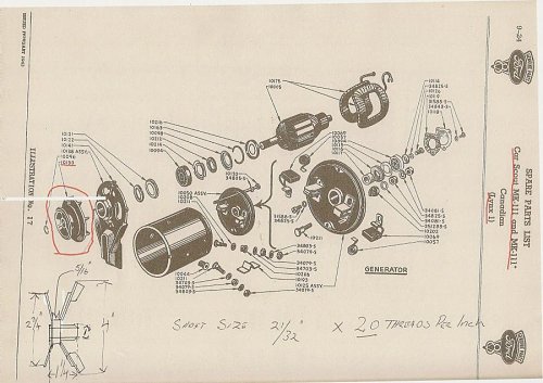

Fan Pulley for Ford Lynx. Part no.10130.
As circled in RED.
The Ford Lynx has a 12volt electrical system and the generator has an unusual pulley. It screws onto the shaft (20tpi) and is held on by a cir-clip type of fitting. Most Ford of WWII are 6 volt (but not the Lynx which is 12 volt) and slide onto the shaft and have a keyway and held in place by a nut.
Measurements are shown on the attachment. Drawing not to scale.
Old age has caused the original to shatter into many bits.
Thanks Rick
Don't know about the single belt pulley found on Ford commercials but the twin belt pulley on Ford CMPs is a screw on type. I'll have a look amongst my genny bits and see what I can find.

I believe this is the same part Rick, let me know and I'll stick it in the post tomorrow.

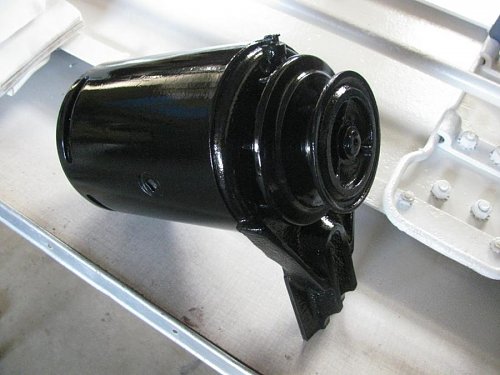

Pulley arrived in todays mail. Only posted yesterday and we live 300km from Melbourne.
Thank you Tony, thank you Australia Post.(Posted at 9.00 in Paynesville 6.30am next day.)
Name:	More Lynx geny etc 064.jpg
Name:	More Lynx geny etc 073.jpg
12Volt Ford Generator is now fully rebuilt with new bearings ($6.00 each) and brushes.
Pulley was perfect and cleaned up well. but I had to refer to the parts book to get the bits in the right order. Must be getting old.
Regards Rick

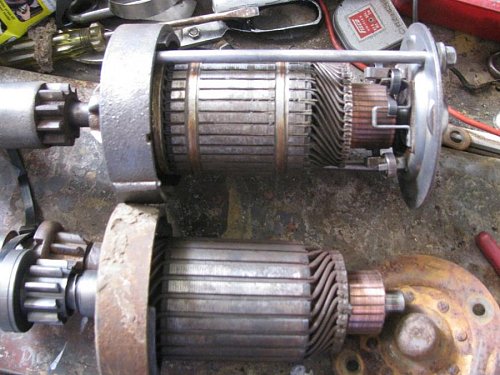

Tony, the body and field windings are the same as the 6 volt genys. The difference is the commutator.
Name:	Lynx bits 062.jpg
It has twice as many windings and segments. I took some photos to show the difference.
OOPs!! that's is the starter not the Genny. Anyway you can see the 12volt at the top and the 6volt below.
Looks like I forgot to photograph the Genny, so I don't know.
Regards Rick.
Excellent comparison photo Rick, very interesting to see the difference. I don't think there are twice as many windings but there are certainly a lot more, presumably to produce the same torque at reduced current. I notice they're much heavier gauge on the 6V starter, presumably to operate at higher current. I'd be interested to hear the cranking speed with your 12V system, should be much the same the 6V system I imagine, which is good.
I had a quick look on a couple of hot rod sites and it turns out the 6V genny will definitely produce 12V satisfactorily, and some rodders only change the regulator. Others change the field coils in the genny as well, using 12V field coils out of later model cars. However I suspect that's more to protect them from higher voltage than anything else. Anyway it sounds like the armature is identical as I suspected, so the Lynx may simply use the standard 6V genny. Unless it has 12V stamped on it somewhere I think we can assume it's identical.
What all this means off course is there's no need to touch the genny when converting from 6V to 12V. Most people don't realize this and go to a lot of unnecessary trouble and expense.
